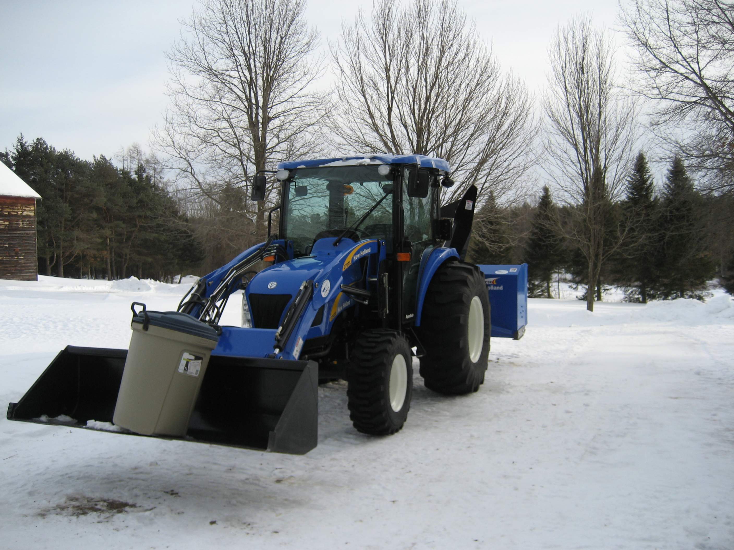

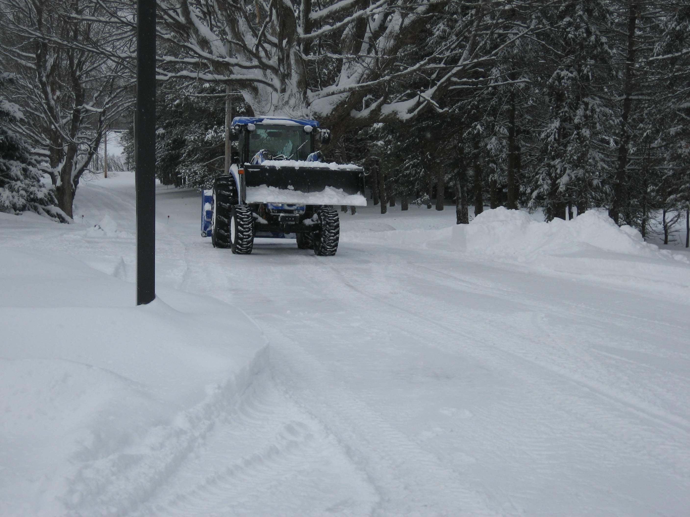

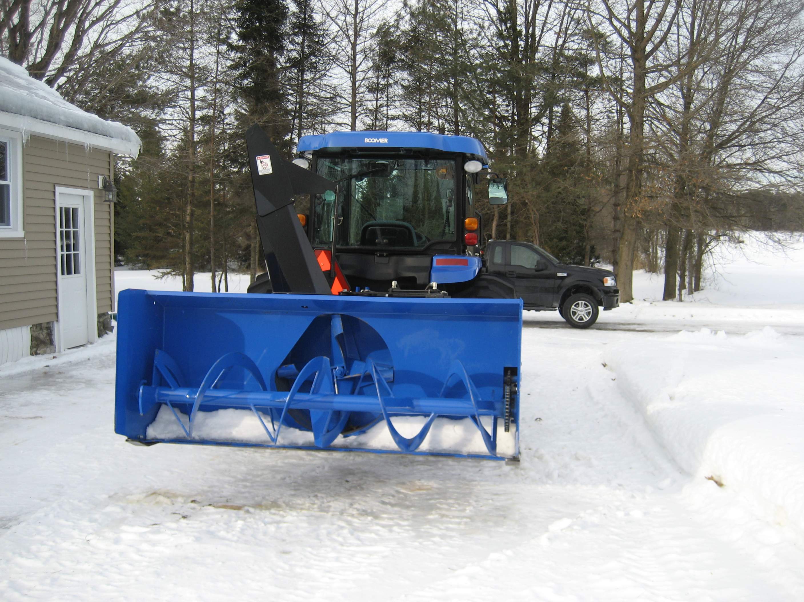

hello from the other side of the tracks the blue tracks that is, I would definitely go with the rear snowblower I have about 1500 foot gravel road and never have a problem just pack the first snow or set the skids a little high for the first few passes then it packs nice and tight no stone-throwing, plus then you have a bucket for that occasional wet heavy snow which we all seem to be getting a lot of in upstate New York during the wintertime. I always had front mount snow blower till this tractor but I've got to tell you it's really not that hard to back up with the mirrors helping now don't shoot me or ban me for posting a new Holland picture in the JD forms ;-).
