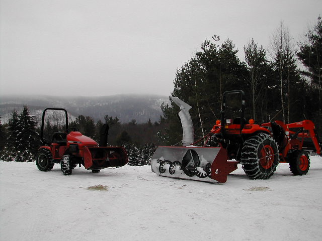

A FM will cost you a whole bunch more than a RM blower at least twice as much.I have no problem using a RM blower and leaving the FEL on.Also I have a 800' gravel driveway and it's nice to be able to take the toplink and shorten it up and angle the front of the blower up to keep it out of the gravel the first few storms and the last couple storms.
