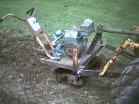

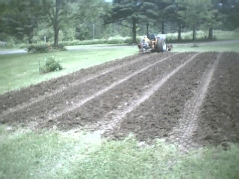

   / Front tine rototiller attached to small garden tractor #7
This is one I cobbed together about a month ago.
I intended to mount this tiller on a large yardman garden tractor, but that will require a lot more fabrication and I wanted to use it now. I just cut up an old VW bug tow bar and with about 2 hrs of thinking, scrounging and quick welding, it does the job.
When running the tiller in high range, it pushes the tractor in neutral. Works great but when time allows I will put it on the Yardman to eliminate the tire tracks.
