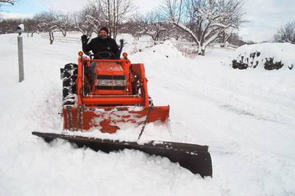

I use an old set of auto tire chains on my front tires size 27x8.50x15. I have no idea what size car tire they came from. My father used them on his car delivering mail in winter. All I know is he had a 15" tire on the car. They fit on my tires but were a little short so I use bungee cords to hold them on. When plowing using the FEL in float mode the tractor tends to go straight. The chains do help with steering a little (better than without any). If you want better steering capability then V bar chains are the way to go. The rear ballast I use also helps a lot.
