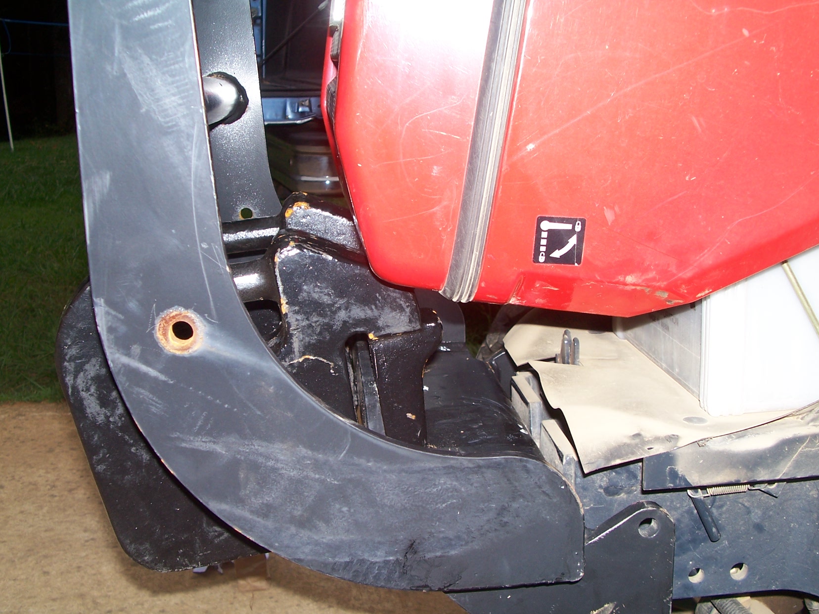

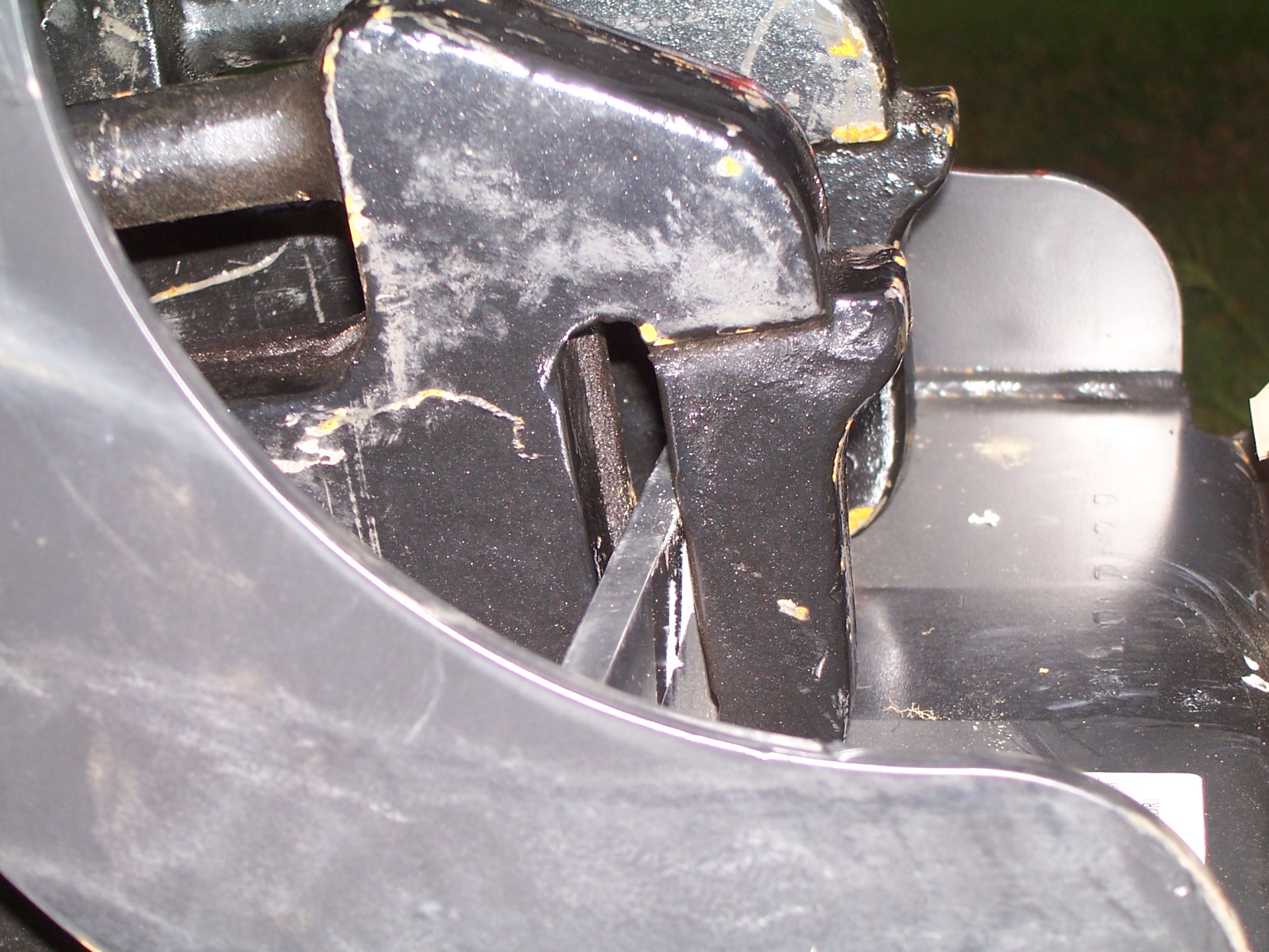

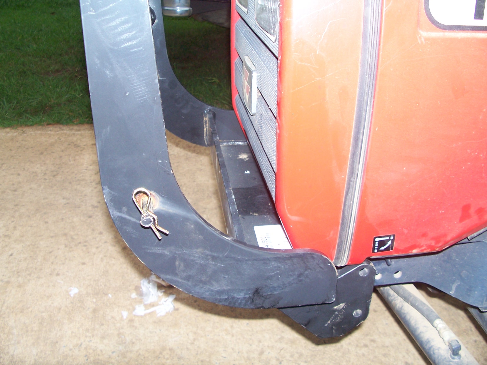

Does any have, or had, the brush guard weight rack, w/o FEL, on their 1433/1533? I bought one with weights, but the rack is so close the the hood, I can't get the weights on. The brush guard/rack is mounted directly to the frame, should there be a bumper or spacer between the frame and the rack? I bought it from the dealer and he had to special order it, not too many attachments for 1433's anymore. I would like to have an idea of what should be going on before I call the dealer back. Thanks.

Can you post a pic of your bumper? They are close but the weights have just a small arm built in to hook them on.

MFRED, here are some pics showing my problem. I e-mailed these to the dealer, and he is going to forward them to the manufacturer. Looks to me like they built the wrong one and put the right part number sticker on it. When the hood is closed with no weights, the bottom of the hood contacts the rack slightly, but not enough to keep the hood from latching.

Yup, that's not going to work. Do you have the original bumper? That doesn't look like the old square guards I've seen, must be a newer style for the new loaders. I think if you had the bumper, it would bring it out about 4 inches.
   / Front weights for 1433v
I just got a call from the dealer. The manufacturer of the rack said that the dealer ordered the wrong weights. The weights he ordered are 41lbs. each, the ones that are designed for it are 25lbs. He is ordering the new ones, need more of course, and the price is the same.
