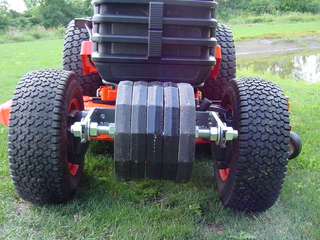

What a difference front weights make. Digging with my dirt scoop would cause my front end to lift off the ground. Using 125lbs up front keeps the tires on the ground and stops the tractor from bouncing.
The cost:
25lb weights- $8.00 each at sears (on sale)
3', 1" threaded rod- $12.39 at TSC
3' "C" channel steel- $8 at home depot
Hardware - $6 at TSC
For 1 suitcase weight (55lbs) at my dealer - $76.00
(It can hold 3 suitcase weights.)

Here's a picture.

Here's how I did mine. There is a bar on the bottom that supports the weight until I slide the pipe through.
<A target="_blank" HREF=http://www.tractorbynet.com/forumfiles/53-134226-weights3.jpg>Inspector507's weights</A>
Quick change, no tools

Those look like weights from a Weider Multi-Station Gym.

Ozarker,
They are from one of those type of machines. They interlock together. Weigh about 11 lbs apiece X9+ bracket+hardware=151 lbs.
Works for me...../w3tcompact/icons/grin.gif
