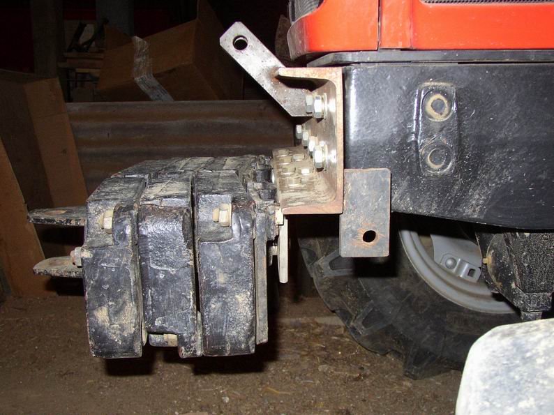

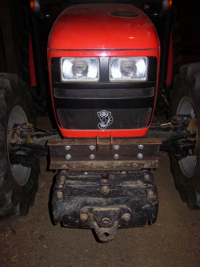

During plowing and disking I felt that is necessary to improve traction I and tractor stability on slopes. I have original front weights on my old tractor. As we don't use it for hard jobs, I was thinking to put existing front weights on new tractor.
Easiest way was make adapter plate for original weight holder, to keep possibility to use weights on both tractors. As I already have U shaped steel rail mounted on front end (for holding grill guard), I decided to bolt just L steel on it.
It is not painted yet, because rusty metal has similar color like dust from field /forums/images/graemlins/grin.gif
Here is final result of few hours job.

   / Front weights
#2
Wiew from left side.

   / Front weights
View from right down to bottom side.

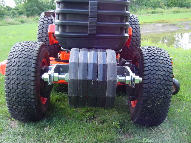

   / Front weights #6
Here's what I made for my Kubota b7500. 125 lbs total.

   / Front weights
#9
RobS,
In attachment you can see both of our family (mine) tractors.
They are not compacts, they are SMALL and powerfull Ag tractors, so I concern them as compacts. /forums/images/graemlins/grin.gif
On STORE tractor you can see my previous project/customization. It is front axle. When we bought this tractor new, it was 2WD. I added (1996) MFWD axle. I also made front fenders. /forums/images/graemlins/wink.gif
SAME was bought last year. If you are more familiar with New Holland, this model has similar dimensions like TN, but lighter little bit.
