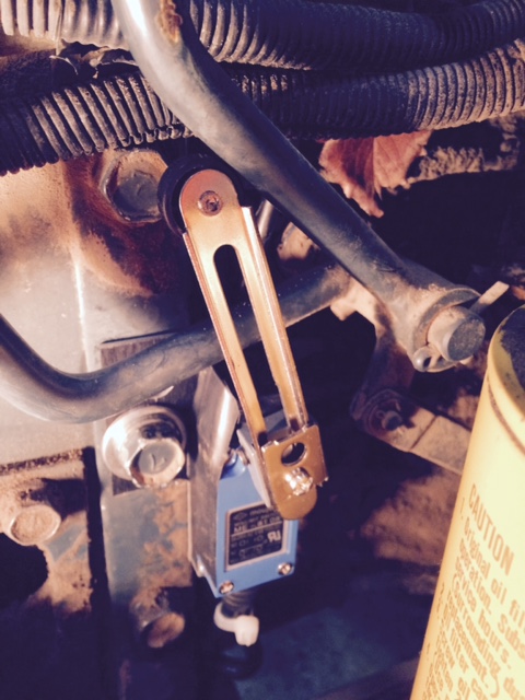

I mounted the limit switch as shown to contact the FWA lever. It will be covered by the stock shield in this area on the Kubota B9200. I'm wanting to mount a flashing light on the dash to indicate when FWA is engaged so don't forget to disengage when roading.
The link below shows one that might work, but its a bit on the small side and not sure if it will wire in and work correctly for this application.
Could use some recommendations on a flashing indicator light that would be a bit larger and more noticeable.
Fake Car Alarm LED Light Chrome Red Flashing 12V 24V Blink Blinking Flash | eBay

I would say it will work great led lights are super bright so should be easy to see as long as you face it directly towards you.

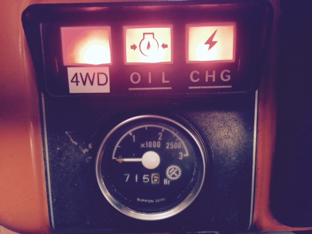

I don't notice any difference on pavement but certainly do on gravel or dirt when turning. I suppose it depends somewhat on the speed mismatch between front and rear drives but driving straight on pavement, I don't notice any differerence between 2WD and 4WD. (FWA)
With that said, I remembered having the extra port on the instrument panel so just added the 4WD indicator light as shown. Do you suppose that Kubota in 1987 knew I would be wanting to add a 4WD indicator in 2016?:)
