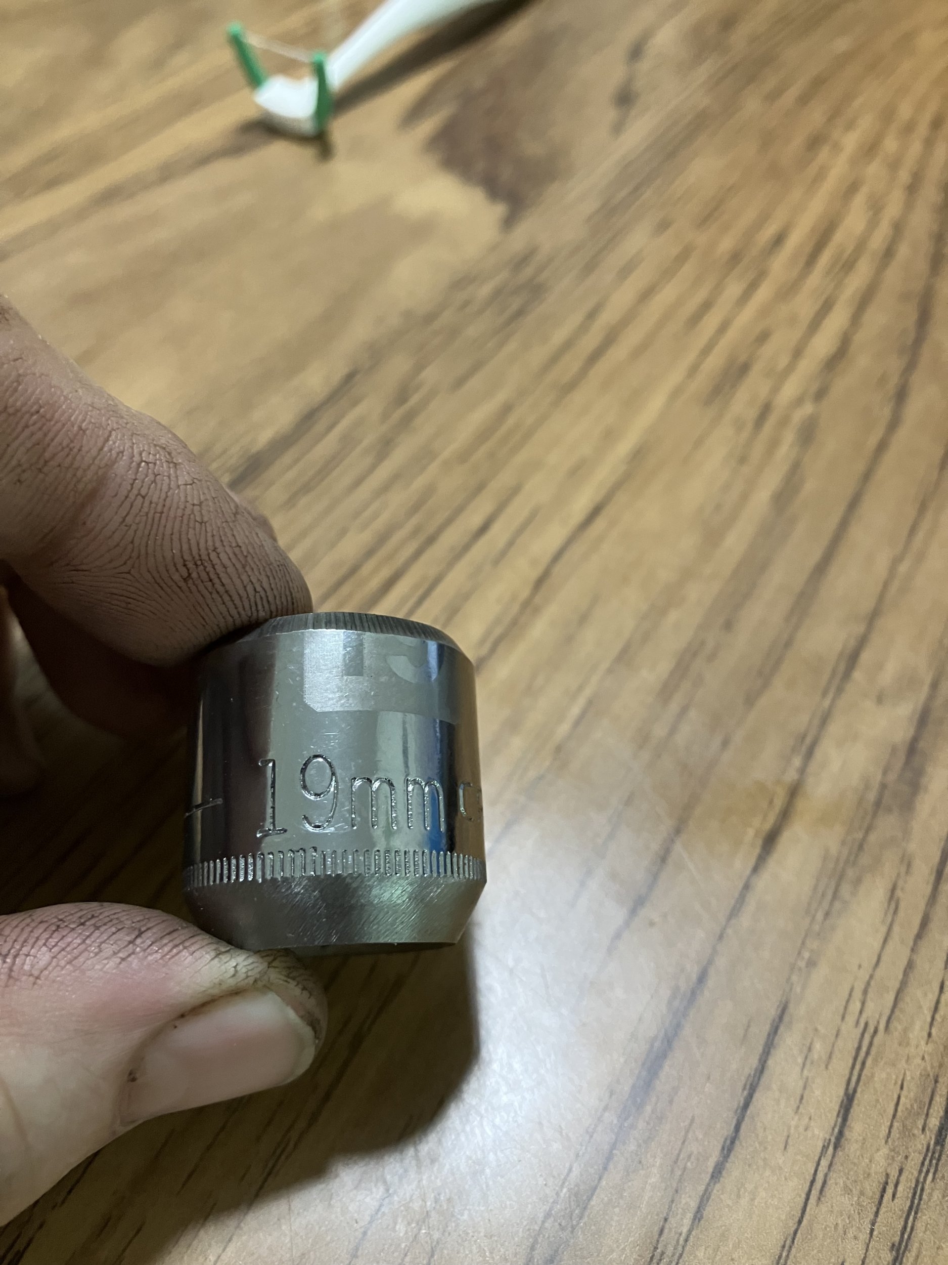

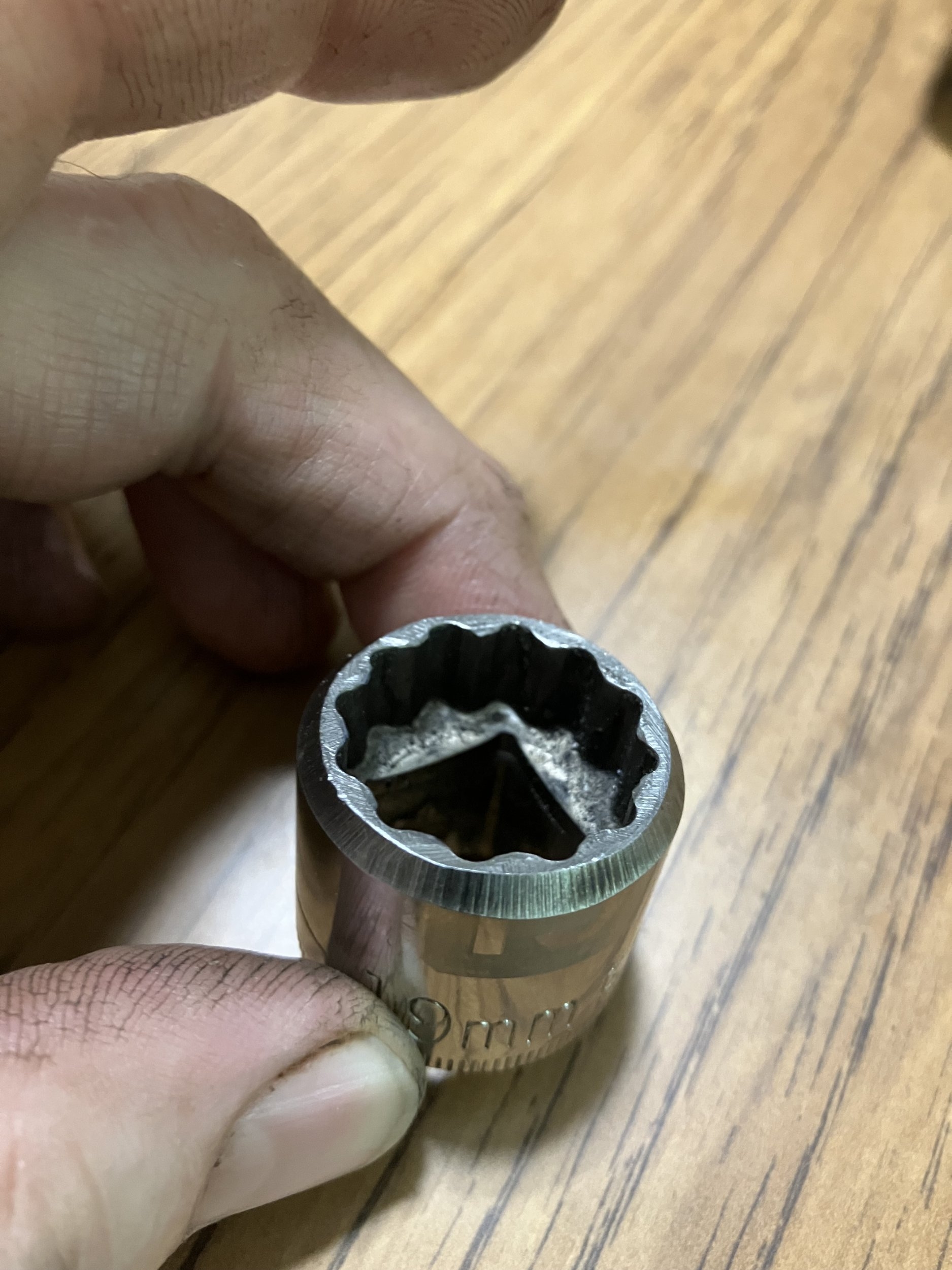

The only difficult aspect of changing a hub is getting a socket that you can get onto the four spindle to hub bolts.
I'll attempt to attach photos of the socket I used. More grinding on both ends would be beneficial.
