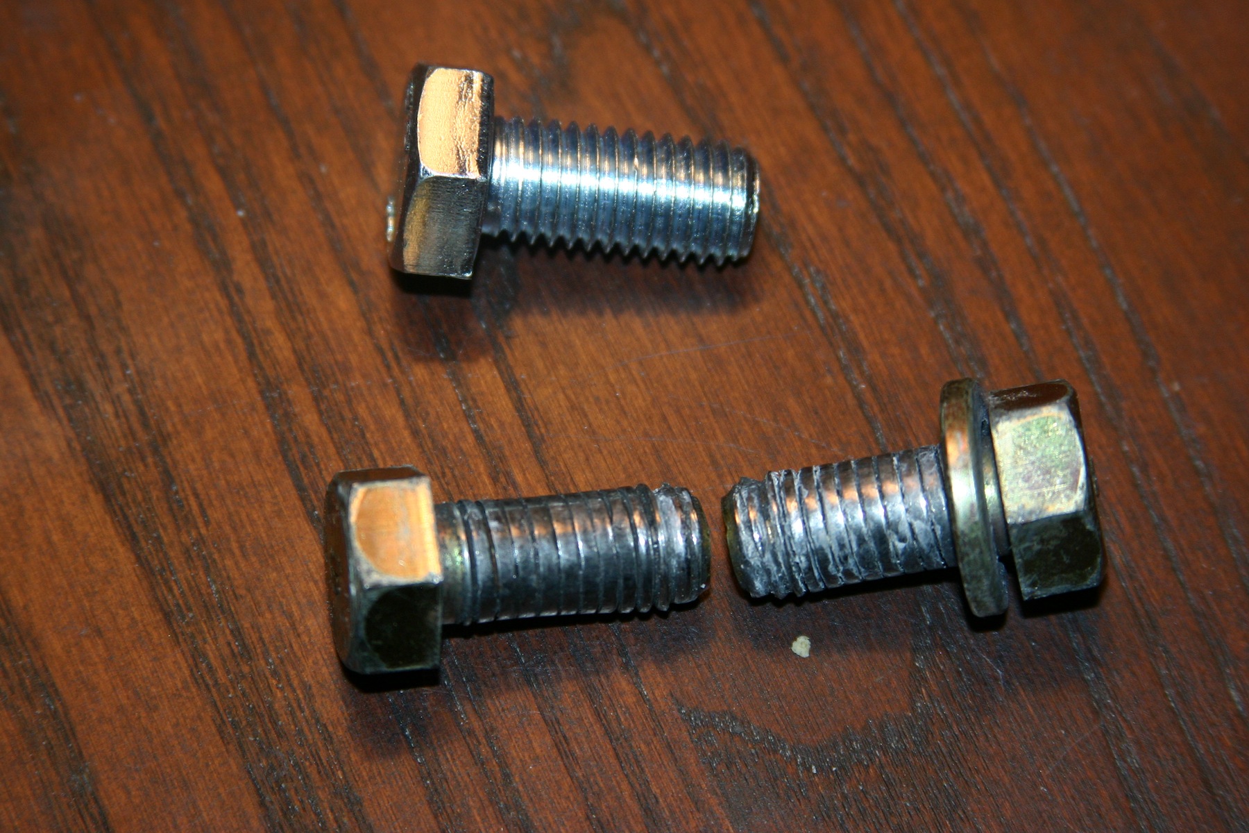

I had quite a scare this weekend with my MF 1428. I was helping a neighbor dig out from the ton of snow we got and the right front wheel buckled and came off. I was pointed in that direction so that wheel had weight on it. The bolts just stripped right out. I was able to jack it up, get new bolts at TSC and get 4 of the six back in got get the tractor back home. I think a contributing factor was that I had the front wheels filled with foam a couple years ago. Doing that added a bunch of weight and I lost a lot of traction. I'm going to have it taken to the shop to have the foam tires cut off the rims & replaced with regular tires again and have them rethread the holes that got striped. Heck, I'm going to have them check everything up front because I bet if this side failed, the other side is weakened too.
The photo shows a couple of the stripped bolts and a new one from TSC just for comparison. I was a heck of a day.

I am not familiar with your machine at all. I am wondering if the bolts may not have been tightened down when you had the filled tires put on? Does M/F say anything about not filling front tires with your particular machine? There are a lot of tractors out there that have front tires filled that haven't had problems. You could retap the the threads and try longer bolts maybe? Sorry about all of the snow out your way. I wish the snow were landing up here in our mountains for a nice heavy snow pack.

Happened to me without filled tires, and only on rt side as well.
(I guessed that it has something to do with rotation and backing out the bolts)
Was result of inadequate torquing in my estimation--never happened again.
I reasoned that slight movement from bad torque allowed enough movement to actually unscrew the bolts.
I simply installed longer bolts (machine screws) and added nuts on the backside.
Have run that way for over 350 hrs without and problem.
In my case the rim holes elongated so I welded a rienforcement plate properly drilled to match drum holes.

I have to agree with K7LN the bolts should be at least grade 5 but 8 would be better. And it does seem odd that there is a lock washer instead of a cone on the shoulder.
If it turns out the bolts are wrong, I would be having a talk with someone.

The bolts that came off were 7s and I bought 8s at TSC. The dealer said he can't do anything until sometime next week. I'm off to buy a metric tap set and longer bolts that I'll attach with nuts.

is the part that stripped in the hub? or did the bolt threads deform?

I got real lucky. The bolts failed completely and the hub was mostly ok. The threads on two holes were messed up but I bought a tap today and they tapped out cleanly. I wonder if this is by design - have the bolts be weaker so they fail instead of an expensive hub. I replaced all the bolts with bolts and put nuts on thew other side. I'm back in business.

oh, and I forgot to mention this. At the hardware store I told the guy I wanted 7 or better bolts. Then I noticed they all had an 8 on them and said that I was OK. He said "8 means SAE 5.5". So I need to get better bolts. Anyplace anyone can recommend that sells metric bolts & nuts?
   / front wheel came off #13
Nuttin wrong with gr5 hardware for general purpose tractorin stuff.
Gr5 went out on old fords.. made near a million of them.. and a good % are still kicking.
I'd be wary of tapped out threads on the hub.. I'd deffinately nut the ones that had -any- thread damage.

I WOULD NOT put a heavier grade bolt in it. I would much rather have $10 worth of bolts fail that I could change in the field than a $900 hub assembly that requires full tear down of the axle to get at.
Think of the bolts that failed as a shear pin. Just like the one in a Bush Hog, Tiller, or Post Hole Digger. They are designed to fail instead of something expensive breaking.

It honestly sounds like he's already got hub damage. IMHO.. I'd not trust a bolt / lug stud, whatever that I had to chase out after a bolt pulled out of it... IE.. the long bolts and the nuts... IMHO.. his hub is already a gonner.. only thing that I might trust is tapping larger size threads in the hub.. etc..

I don't think that lug bolts should be considered as shear pins.
They are to hold the wheel on and not fail, that is probably why there is more than 1.
Especially on any alloy wheel it is recommended that after replacement the lugs are to be retorqued after a few miles.
Its not a bad idea on any wheel.

put helicoils in where the threads are damaged, put the right OEM bolts in, torque it to spec and it will be good for life. Tire bolts don't just fall off when they get bored or tired.... my guess is they were not torqued right at some point in their lives.

If the bolts you show in the picture are representative, they did not fail, they came loose. This has nothing to do with grade.
I would not go up on grade unless it is convenient, and it sounds like it is not.
The threads look like they are not torn nor broken, rather, they looked hammered down by the rim hitting them from the side.
If not for the racket of your engine, etc, you might have heard the wheel making noise each rotation.
I think it is likely that your hub is fine, but I do like the idea of the nuts on the other side of any hole that the tap would not start and run in by hand during the tapping. I would be watchful to make sure the nuts will clear everything in all cases.
The foam in the tire did not cause the problem. I agree with Dave that the lower traction is likely due to lack of conformance of the contact patch.
I would insist on new lock washers now, and each time those bolts are removed in the future.
