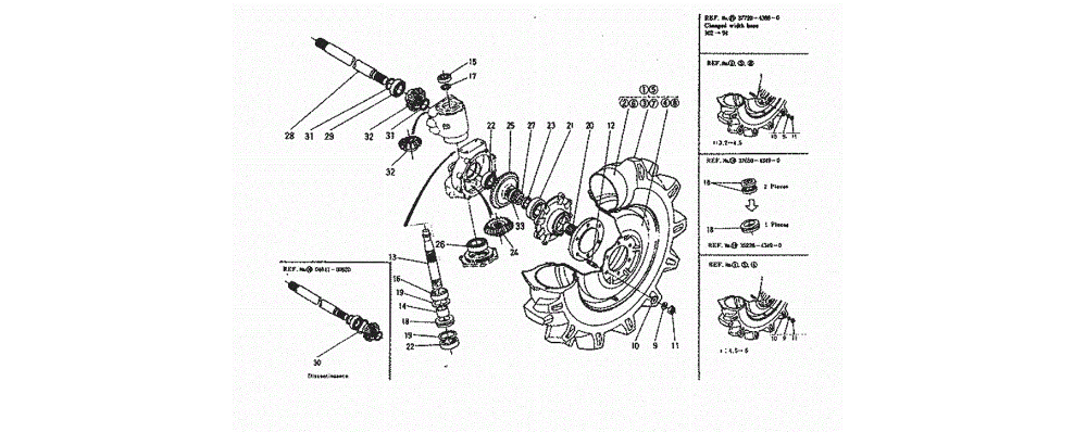

Hi ,
I have a Kubota L245DT which has a small leak on the left front wheel.
Which seal(s) do have to replace and where can I get them. I have the parts Manual but it is not clear to me which parts need repair.
Anyone who did replace this before? Any help is very much appreciated!
Thanks,
Joe

Hi repete , can’t send a pic now.
the leak is where the upper part of the front knuckle is pivoting on the lower part. I can see it’s oily between the two parts and from there the oil is leaking downwards.
thanks

If it is leaking between the upper and lower pivots, you will need item #18-35226-43490 seal. Plus 32448-99150 gasket, 37650-43470 dust seal, 04811-50900 o'ring. Also 37720-43550 o'ring and 37650-43530 seal. These are the items that I usually used when I was at the dealership.

When you disassemble and reassemble, make sure you keep any shims in the SAME place that they came from.
