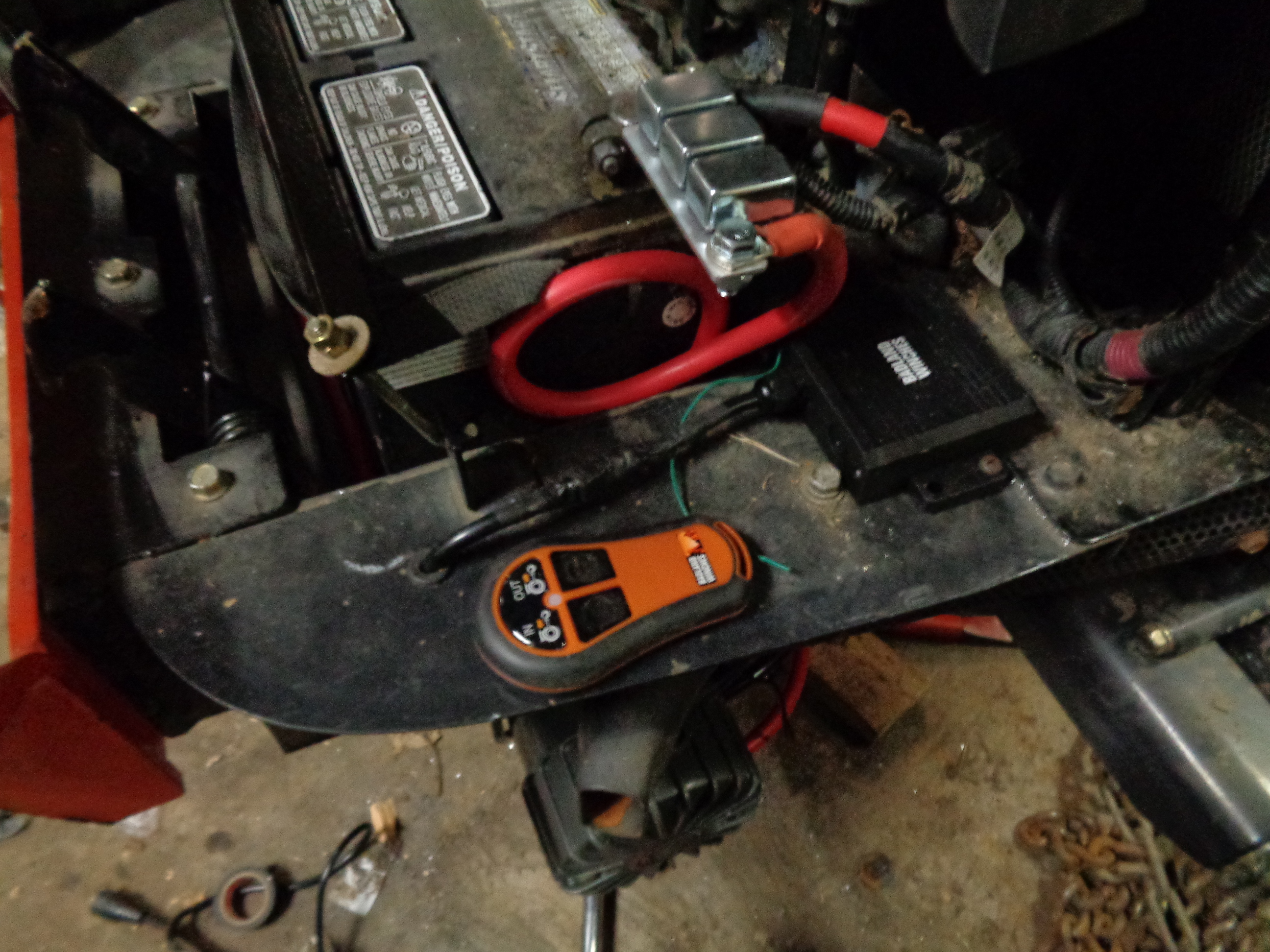

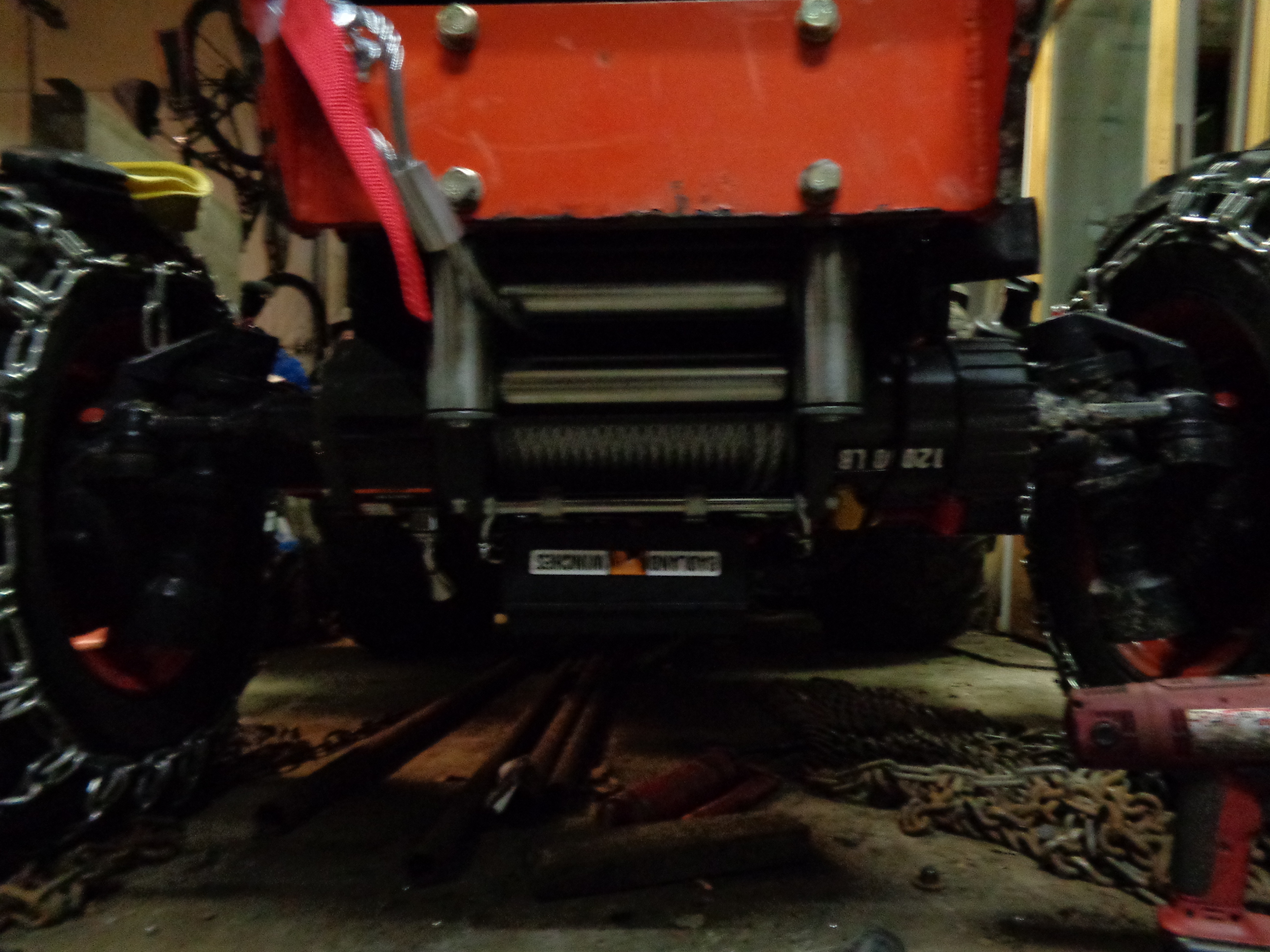

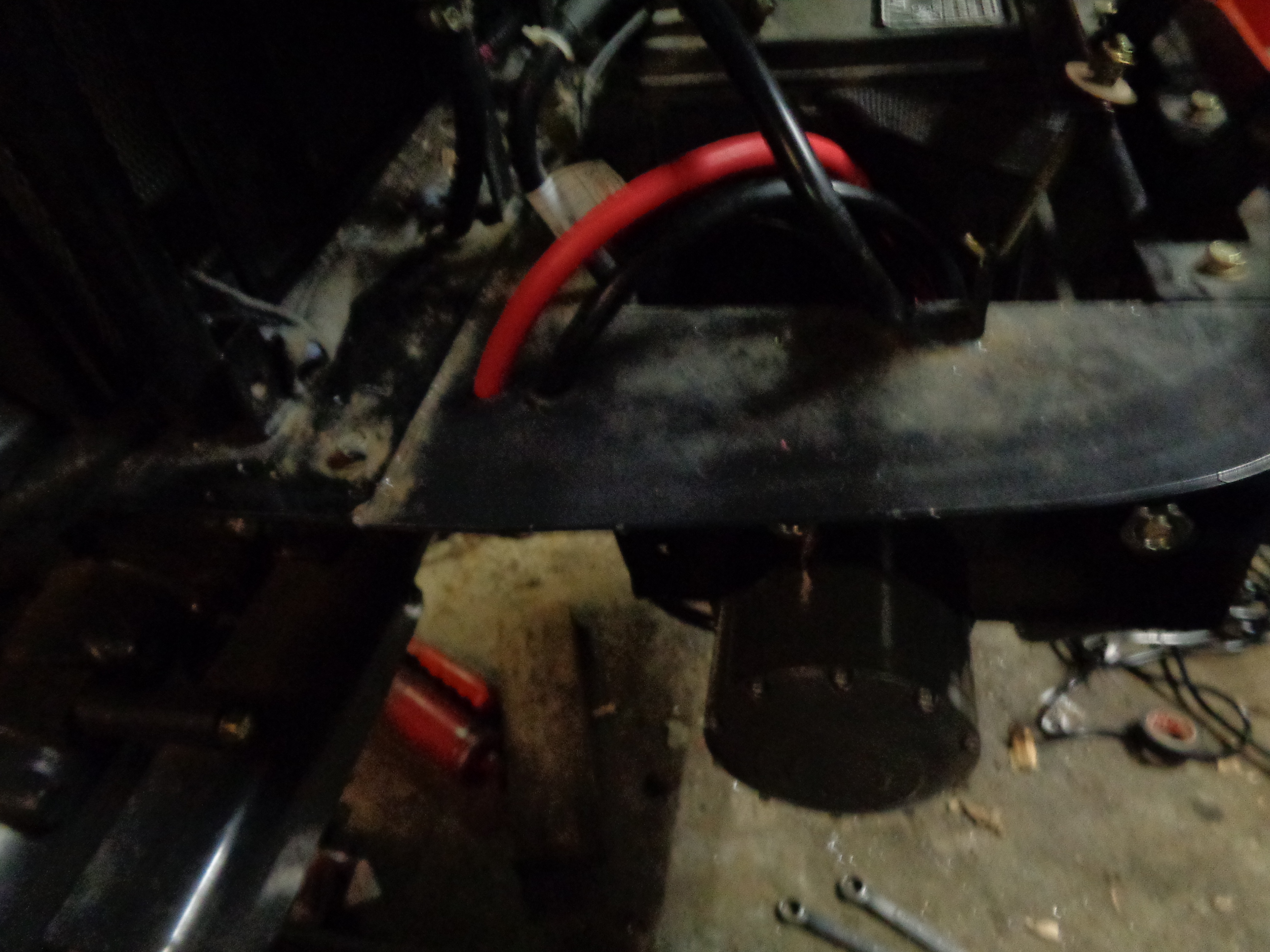

I decided to add a 12,000 pound front winch on my tractor for holding power while using my logging winch on frozen ground to pull in logs. The install was lots of fun making a perfect fitting H frame to wrap around my tractor frame. It did turn out nice and clean and I am happy with it. Now I just need to go try it out. I do have a 50 foot remote button for it.

Very nice. Follow up with a useage report.
   / Front Winch Install #3
Looks like you did a nice job tucking that winch in there :thumbsup:
Be VERY carful holding a tractor back with a front winch while winching from the back! It really isn't all that hard to pull a tractor into two, especially if the log hooks something and jerks on the line. (shock loads)
It happens pretty often when some one pulls out a stuck tractor from the front, that's something I rarely do on a "frameless" tractor...
SR
SR
I have that already in my mind as I was told this by another tractor owner. He said no jerking, go slow. Always check your bolts.
