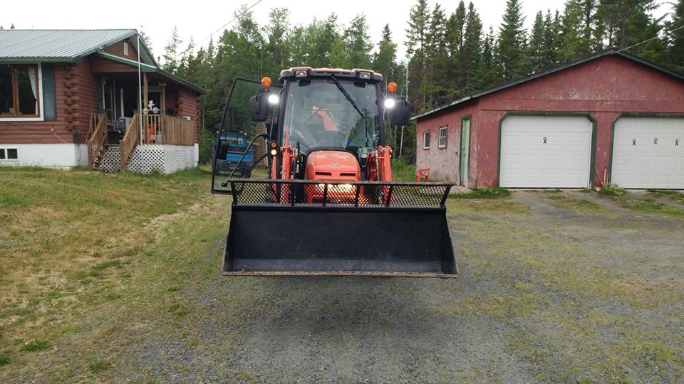

FRont wiper on my 2009 kioti cab loose and will not work can somebody show me a diagram how is is built do i have to remove intrioe roof to fix ? help , I an in a snow storm

2009 factory cab
   / front wiper on my kioti cab dk35 #3
Lift up the hinged cover , they're will be a nut usually 1/2"/13mm holding wiper to a fine splined shaft, make sure wiper is where supposed to be in off position, tighten nut up and should be good

than k you ever so much
