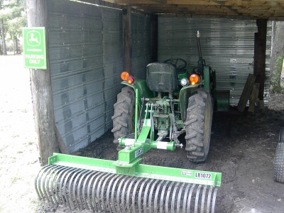

Roy,
Attached is a picture of my Frontier LR1072. I love it. I would rate:
Quality-excellent
Welds-excellent
Paint-average.
As stated by others, made by Woods. Here are the specs for all from my owners manual:
LR1072: weight 270 lbs tractor size:12 to 20 HP
LR1172: weight 305 lbs tractor size:12 to 40 HP
LR1184: weight 324 lbs tractor size:20 to 40 HP
LR1196: weight 359 lbs tractor size 20 to 40 HP
ALL:
Positions: Angle 360deg. Locks at 0,15,30 deg. forward right or left and 0,15 deg rearward right or left
Pitch adjustment: by TPH top link
Teeth: 5/16x1" Spring steel, heat treated (double bolted)
Hope this helps.
