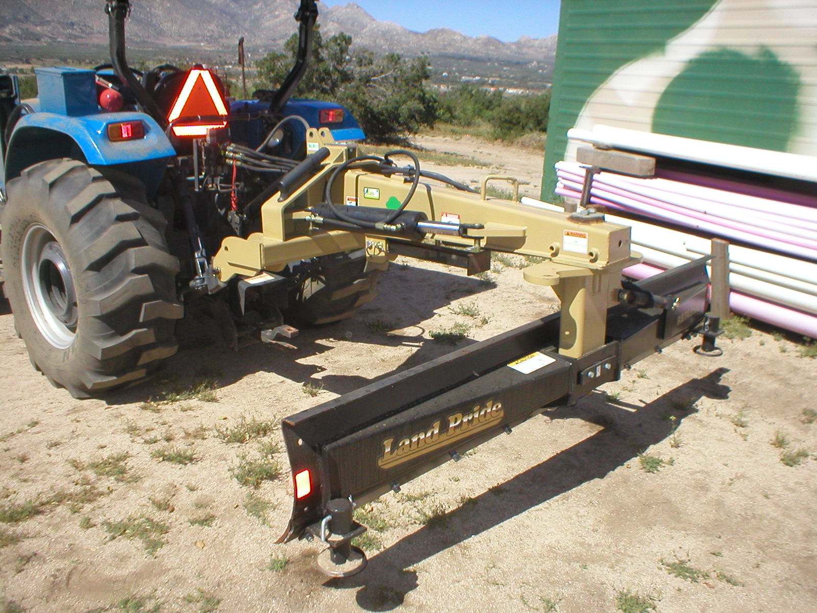

With that tractor, I would go with the 24 series or the 45 series LP. Why are you asking about a 7 foot blade? :confused: You should be running an 8 footer at the minimum, I run a 9 footer with my tractor, an RBT45108. My machine weighs in at just over 12,000lbs.
