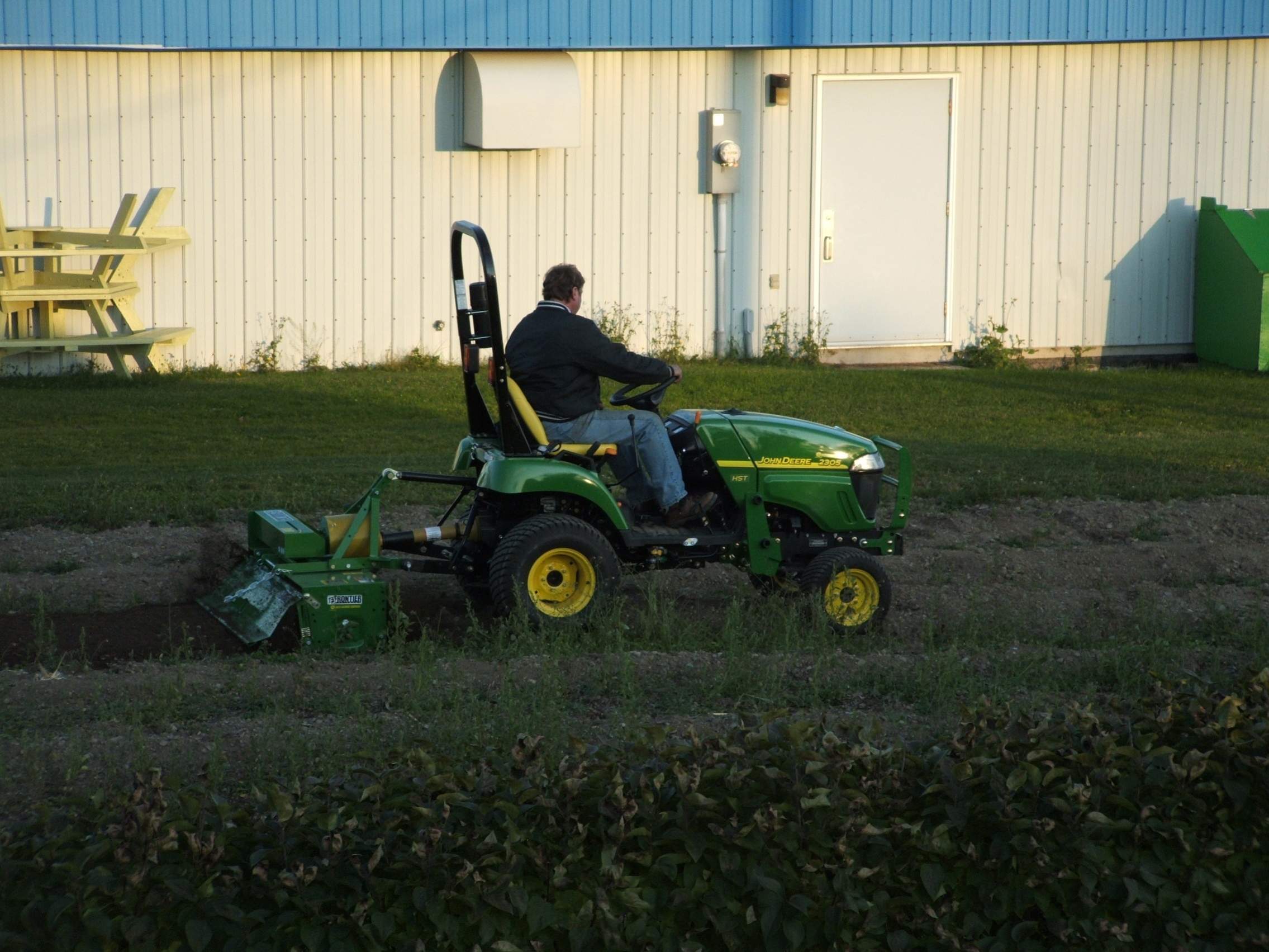

I operate a Frontier RT 1150 for the last 3 summer and have been very satisfy with it. No problem what so ever. But it is a bit smaller than what your looking for.
