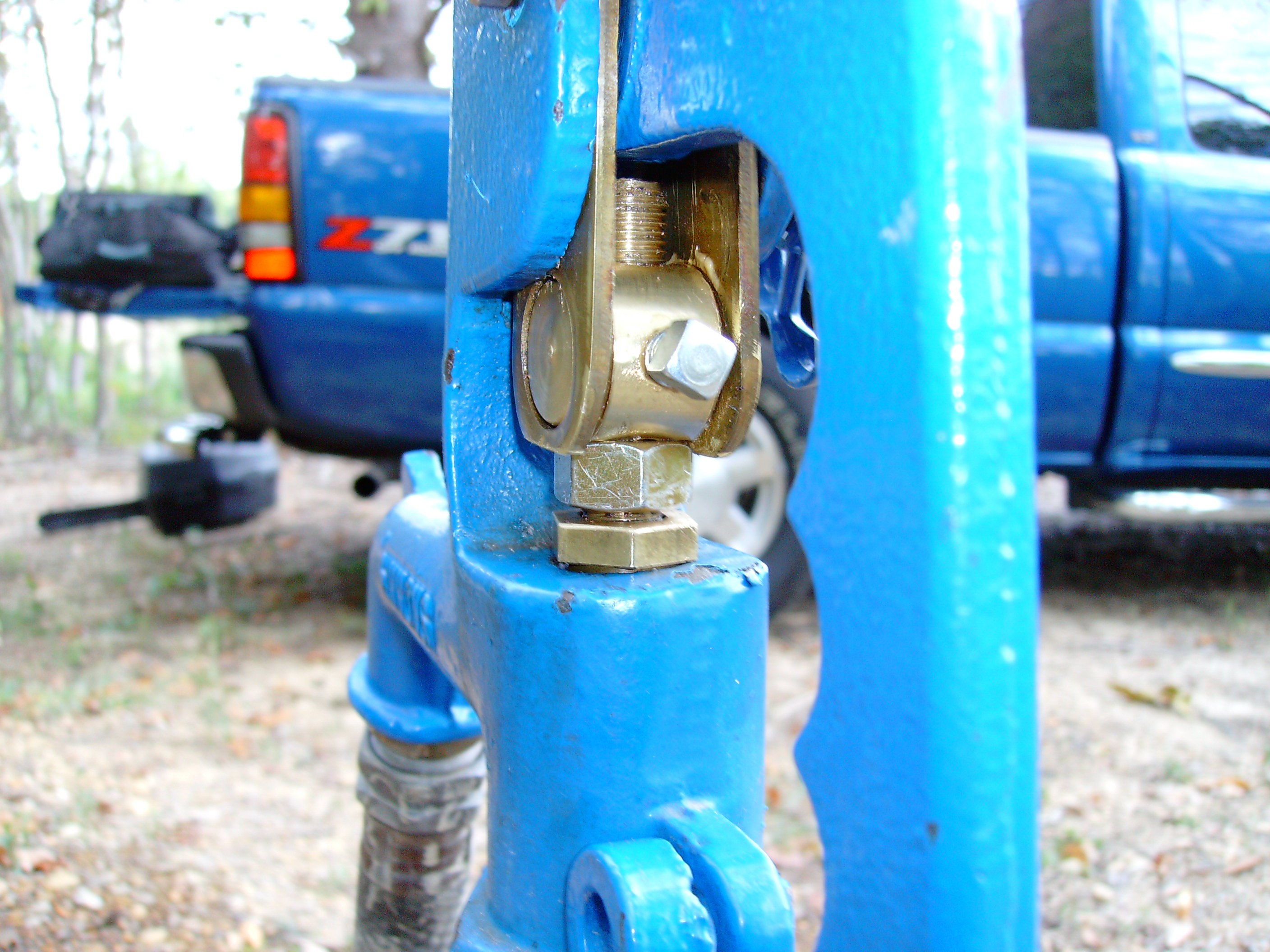

Wonder how the cost of the Baker spool valve models compares with a Woodford and the cheapy Simmonds from Lowes? I'm using 7 of the Simmonds. Been in for about 7-8 years now. They work ok as long as you don't regularly use them or your wife doesn't run over them with the bushhog.:duh: The handle-to-stem linkage to lift the valve plug is not the best design IMHO.
I had to modify this one to thread the stem and add the adjusting nut after the square head setscrew stripped while trying to get enough down force to seal the plug. One factor in their favor; they almost match her truck!
