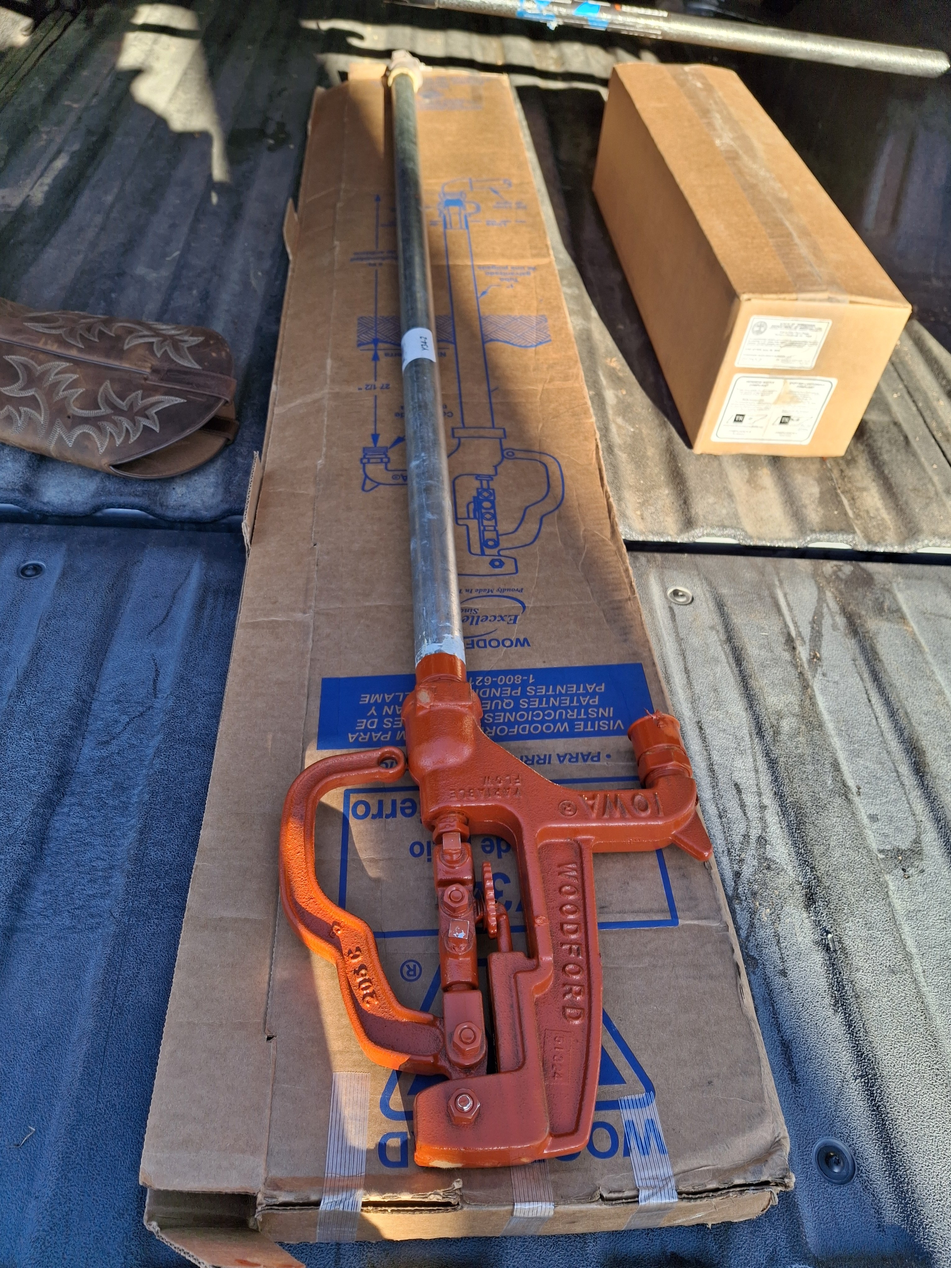

I know, old thread, but 'tis the season. I have had two of the cheaper Hydrants fail over the last 10 years. So I am trying a Woodford Model #Y34-4 this time...it was $197. The cheaper ones are $100-120.
