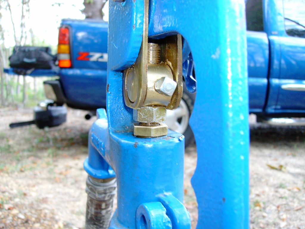

DON'T get the blue ones they sell at Lowes!! "Simmons" IIRC. I've got six of them! The lifting mechanism is not very robust.

We bought 2 of the Simmons from ebay fall of 2013 for $85 for both including shipping. Installed one inside and one outside our barn. They are both used every day multiple times a day with our goats. Only had one issue with them and that was the bolt that goes through the handle to the valve. The nut came off the bolt and let the bolt slip out. Replace it with a nylon lock nut and they've been fine since. No signs of leakage or anything. We would buy them again - at least so far with only about 18 months on them.
