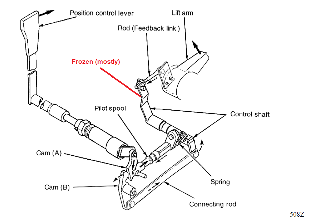

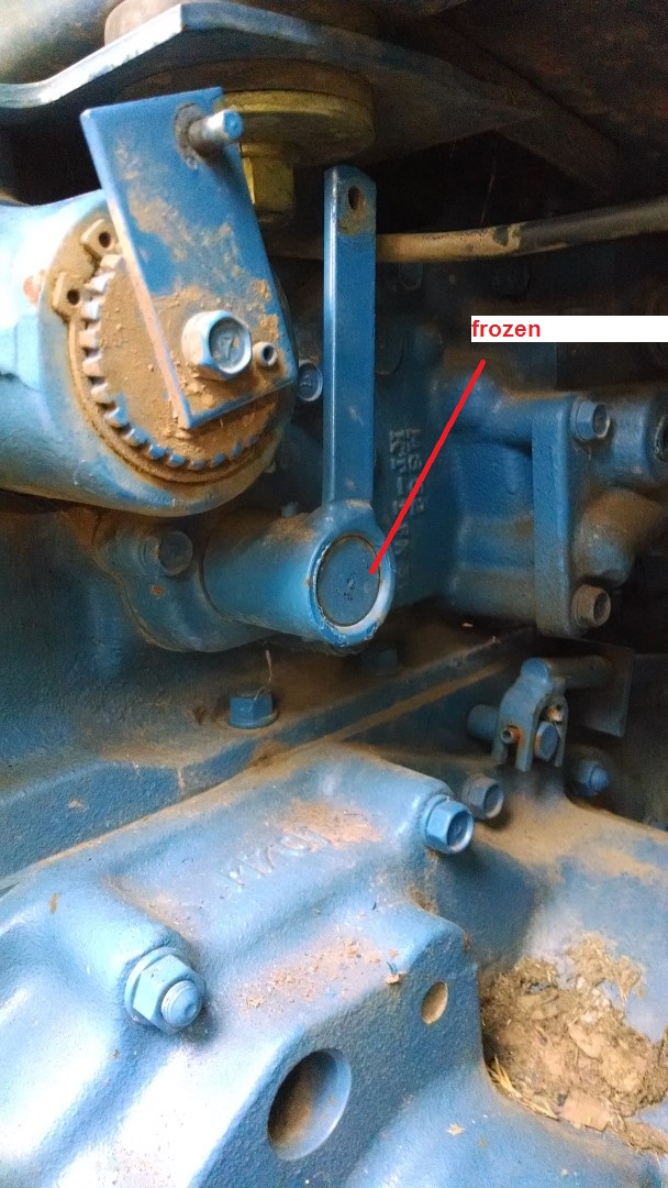

Brand new 1920 owner. The feedback mechanism for the 3 point positioning seems to be frozen. When I bought it the little L bracket connecting the feedback rod to the control shaft was snapped. I replaced the bracket and the shaft will rotate a little, but then the new bracket snapped as well. I imagine this should be very loose.
Any idea? I'm guessing I'm going to have to take the cover off and clean up / grease the entire mechanism. I have a copy of the Shibaura ST440 manual (similar), but the instructions are VERY light. Having never done this before - anyone have any tips? It looks like I need to drain the hydraulic fluid and remove the valve cover assembly, which should give me access to everything I need. Any tips on that? What body parts can I easily remove to get better access to this area?

The connecting rod is a hinged parallelogram that links rock-shaft to the spool valve to return it to neutral position at any given 3 point height. The hinges have a rod and a pin to tire them together. I think you might have a rid bent or pin busted. You do not need to take the cover off to observe and even get your hand in there to work. if you move the lift cylinder head and withdraw the lift cylinder then the spool and associated bracket and part of rock-shaft will be exposed.

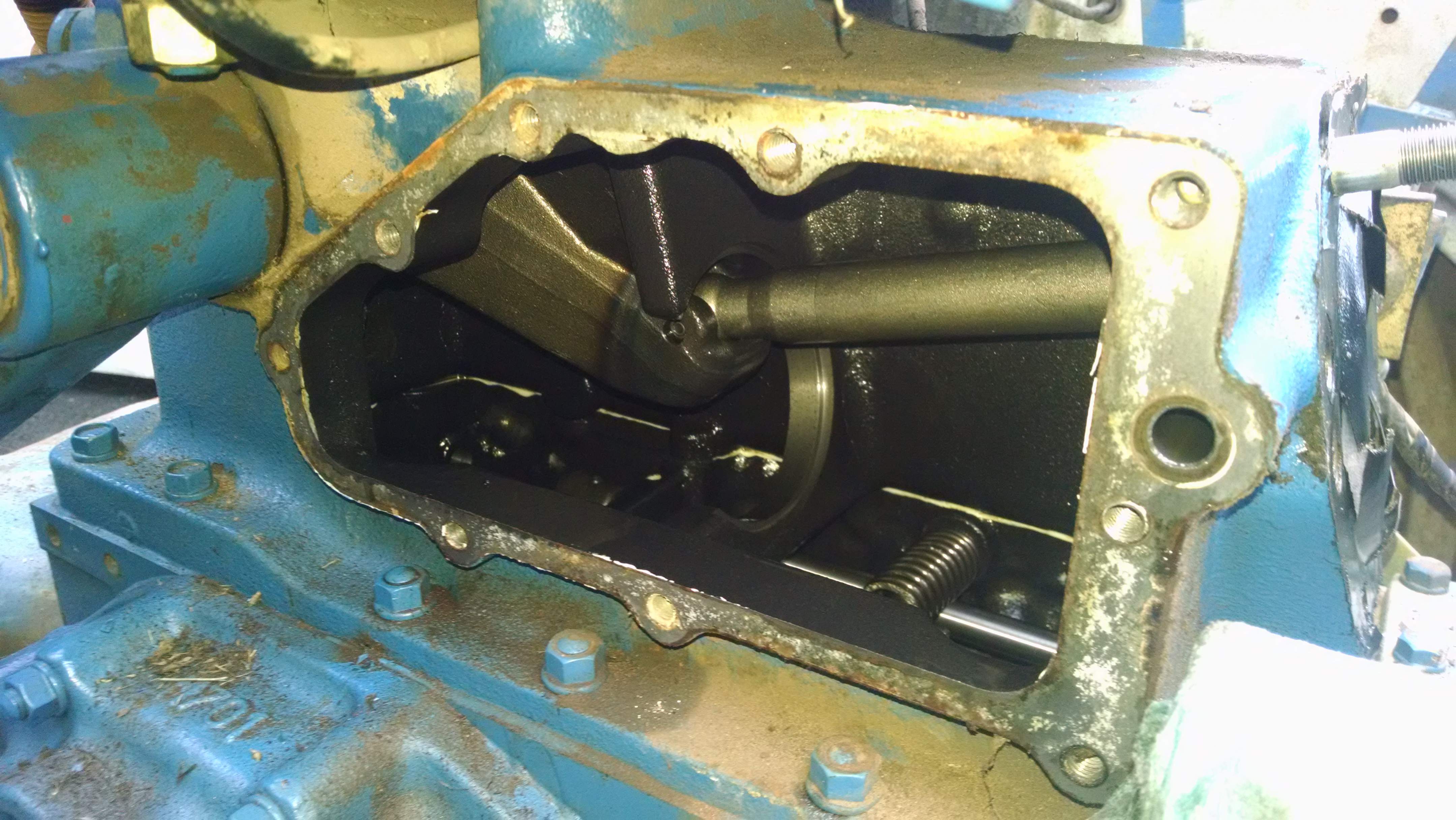

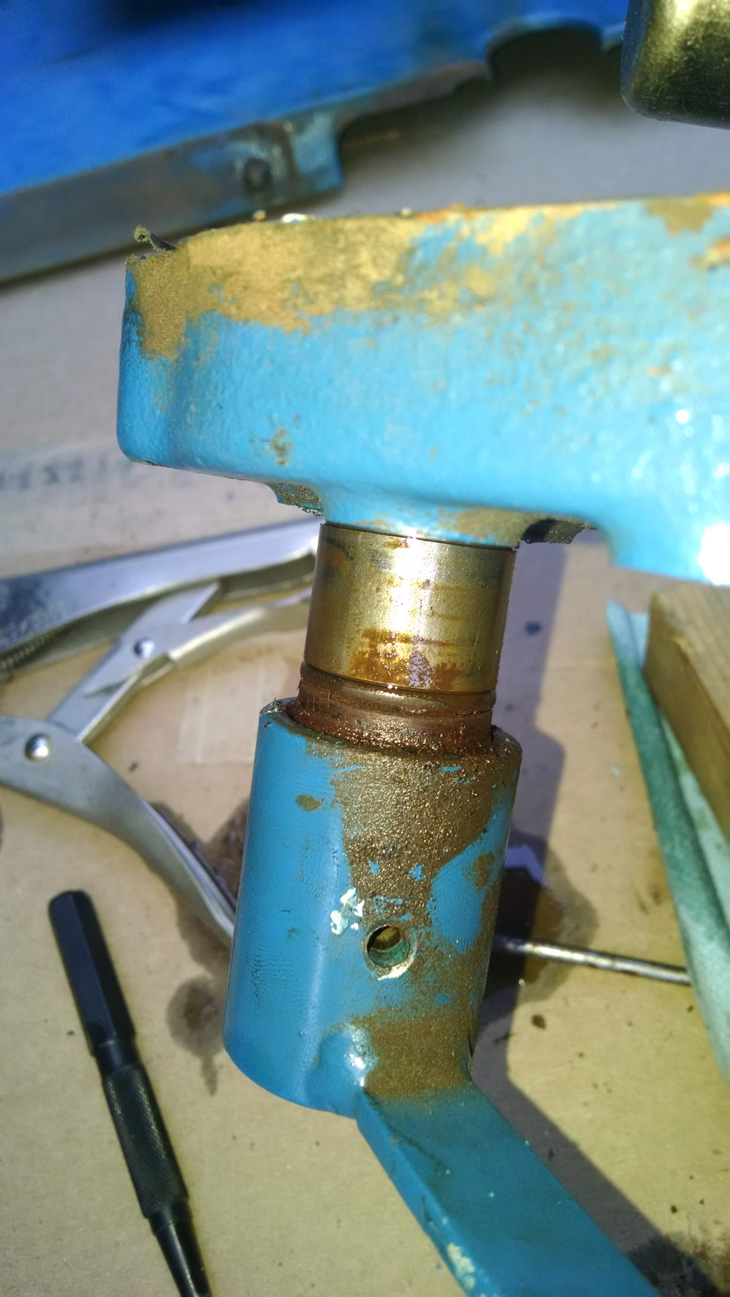

Fixed it (thanks for the help JC).
I removed the piston, but all looked good on the inside. Nothing broken, bent etc. So I then pulled the whole valve cover off (had to remove the fender - not too bad), removed the snap ring, banged the feedback shaft out a little and cleaned everything with WD-40 and some steel wool. After that it turned smooth as can be. The O-Ring looked good, in fact none of it looked too bad - it looked like it just gummed/rusted into place. Here are some photos for anyone interested:
