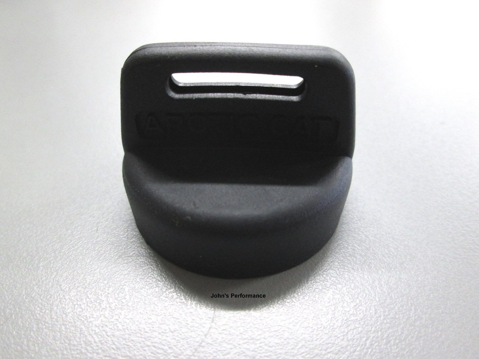

If you can find a snowmobile key cover, it'll prevent those kinds of incident. Since then no more problem for me.
