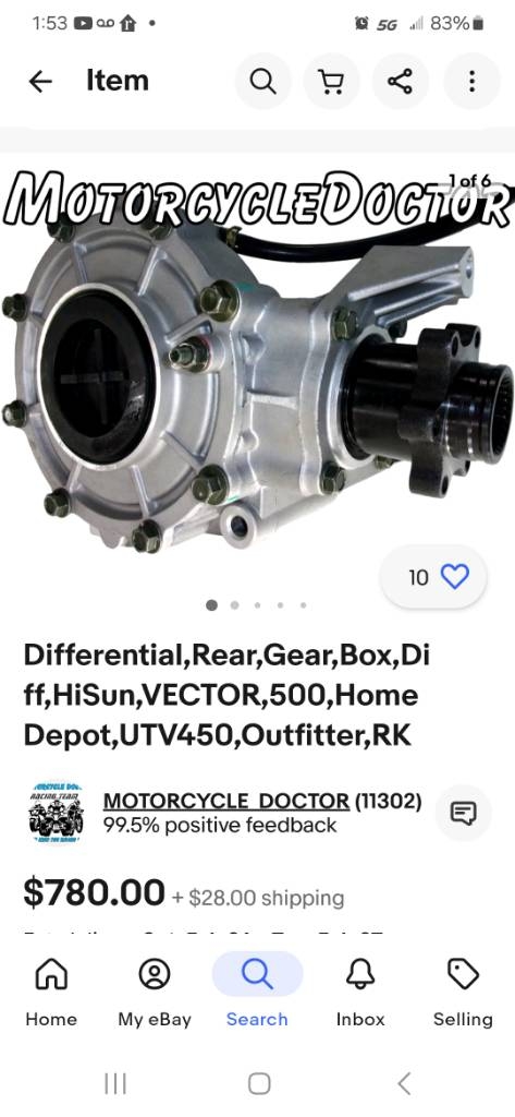

Totally locked up. Had problems in the past with it. Started out when I first took the rear axle out, I found the pinion nut was totally backed off. I'm sure that didn't help.
I found 1 on ebay but either the guy wants to make sure I get the right part or he doesn't know what I'm talking about. I sent him a pic, bad pic but it showed the rear axle.

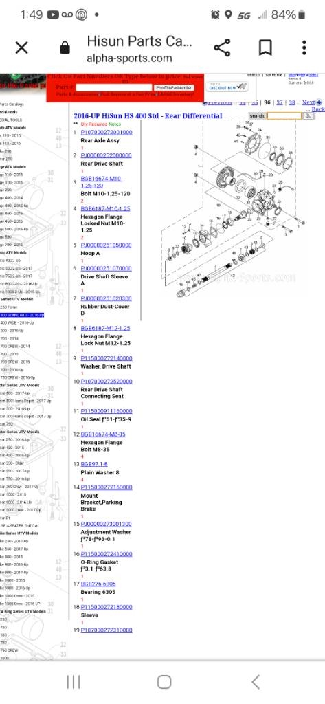

Not sure on that exact model but many of the chinese SxS from tractor supply and the like are clones of major brands ie yamaha rhinos and many of the rhino parts fit
This right here. Check for any clone vehicles. If you can find a parts diagram, then search the individual part number, on ebay. Good luck. Most likely there are multiple clones, and with any of those clones that you can find a parts number for, 'should' work.

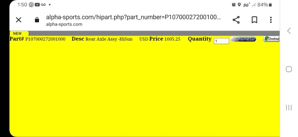

So, looks like the entire rear axle assembly is $1005. I would probably try to diagnose further than 'rear axle assembly' down to a specific part or sub assembly that is causing the issue.

Taking that part number, I found more on Ebay.
