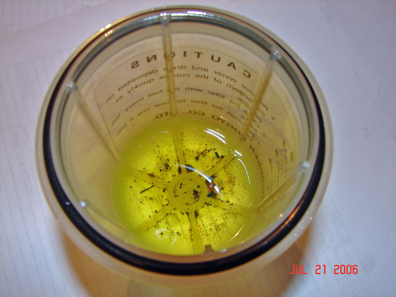

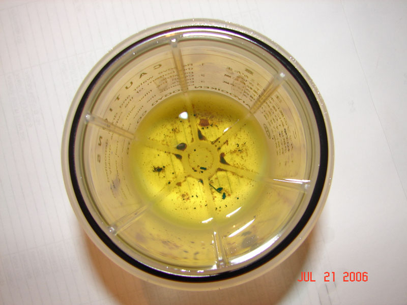

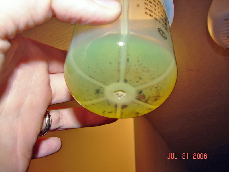

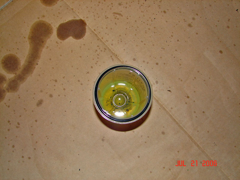

Here are a few pictures of my sediment bowl and the crud in it. Anyone have any concerns??? I guess my filter is working correctly. Changed the filter anyhow for the sake of doing it for the first time. I have no idea if they did it at the 50 hour service or not. They changed all other filters so I'm guessing they did but, they couldn't remember for sure or not when I asked. Reinstalling fuel filter and sediment bowl wasn't any problem. I filled the bowl full. Left the retaining nut a little loose. Then turned the fuel back on and tightened as fuel slowly overflowed the bowl. Just for piece of mind I opened the bleed valve for about 10 seconds to assure no air was in the line. Cranked the engine over a few seconds to bleed the high pressure lines and then started her up. She didn't miss a beat.

Hey did you know that you have crud in the filter bowl? ;)
Consider the fuel filter is doing it's job and sleep peacefully. :)

Greg, I think your filter has done a superb job of stopping that crud from getting into your injector pump. It seems some states just have more problems keeping fuel clean than others. (I said "states," but maybe should have said "regions.") I've never noticed any water and extremely little sediment in my fuel filters. Heck, on my diesel pickup, I went over 100k miles on a filter and it still looked like new when I replaced it. For some reason, we get very clean fuel here in N. Texas.

Hey Mike.... you know what????? I thought I seen a little bit in there.:rolleyes: I was not sure so I thought I'd see if you guys could see any?:D Thanks Mike.:) I did sleep peacefully for 4 hours and didn't get up this morning very willingly. :mad: :)

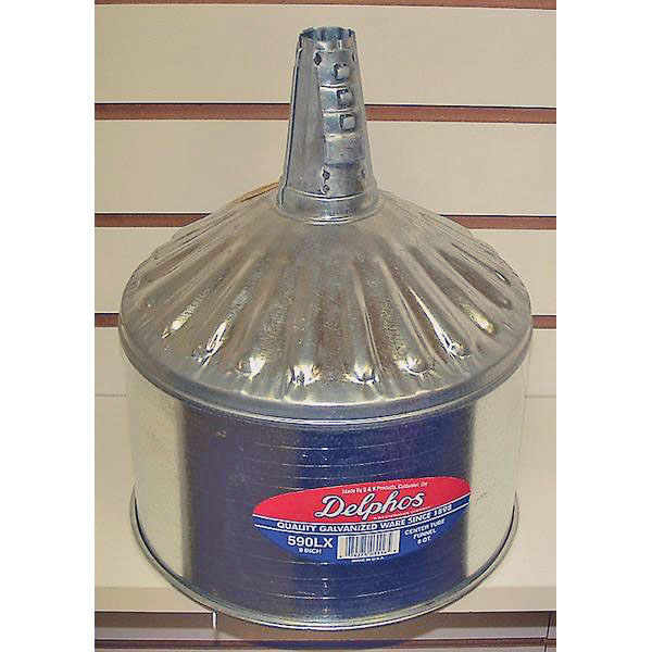

Jim a lot of that crud could possibly be my fault as well. On top of possible dirty fuel. However, I've always got my fuel from the new Murphy station there at Wal-mart. New storage tanks but, possibly dirty fuel from the delivery truck. Another mistake I may have made was over the winter when I used about 2 gallons left in a jug in late winter this year that had been sitting there since the end of last fall. I didn't notice it at the time but, it had a little red algae in it. For a funnel (see attachment) I use one of those 8 qt. Delphos from TSC that has the wire mesh so I would think I'd catch a lot of the bigger garbage that showed up in the bowl. However I've probably knocked some debris in there as well when fueling up out in the field when bush hogging. The crud in the bowl kind of reminds me of hay chaff. I didn't inspect it that well to see exactly what it was.

Here's that picture of the funnel.... which by the way is my favorite style of funnel for refueling my TC. Fit's in the hole solid and doesn't move. Probably what half of us use here I imagine.... being that it's available from TSC.
