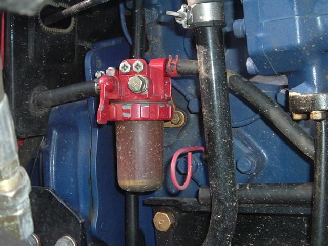

hi everyone ,sorry I know this is a old thread but when I went back to read all posted some you can't redirrect ,I have a drip leak at the fuel filter area ,small drip .took the bowel off and made sure that the o-ring sat right the retighten it turn the fuel back on and after 6 hours I seee uder the area small fuel drip going down the bowel and then off the bottom of the bowel and on the floor.what to do????Harry Ca.ps the charging light seems to be now ok.

I had the same thing happen to me and after taking it off and reinstalling it several times with a new o-ring, I discovered that there was a hariline crack in the bowl right at the lip of it. It was very hard to see and only leaked when the collar was tightened.
/ fuel filter leak #3
Order a new fuel bowl, oring, and filter. I was told that the original bowls shink over time. When u get a new one it will look a little different not quite as clear and softer... I am supprised if your tractor is running good? Make the switch and u be happy!

A new bowl and o-ring didn't fix my leak. You didn't say, but if you have fuel on top of the filter body, you might want to check the bleed valve.
The filter body on my 2220 had a spring loaded "push-button" bleed valve and overboard drain which was very convenient for bleeding the fuel lines, but the leak was around one of the seals in that. Ran across the top of the filter body, dripped down the bowl, and spotted the floor under the tractor similar to your description. But there was also fuel on top of the filter housing.
I finally stopped the leak by replacing the filter housing. Lost the push-button bleed convenience, but at least it doesn't leak anymore.

We have had a number of those spring loaded bleeders leak, and have not found a good way to repair them. We just replace the fuel bowl head with the version that has bleeder screws...it costs about $28.00 but is rebuildable and virtually never fails beyond repair.

okay I ordered a new bowel and o-ring (hoye tractor),only question is were on the fuel filter houseing is the bleeder ??? ym 1610d I am not that good with a wrench so t-a-l-k slow,lol.Harry

There will be two....Just above the fuel bowl assembly - one on the fuel tank inlet side and the other (about 2" to it's right) on the way to the fuel injection pump. They are 10mm hex head (centered with Phillips screw) and there should be another (third one) centered at the banjo fitting on your injection pump.

thanksfor the pic that was great , now do I loosen both the screws and let the bowel fill up until full ,is that correct?sorry for the stupid questions ,think mine his 2 small screws at the top and a bigger hex to the right side .

Do them one at a time...and do as buppy69 states, fill the bowl with fuel and reassemble.
The systems is designed to purge any/all air trapped in the fuel lines. Start at the left 10 mm bleeder screw and allow the fuel to drip (for several seconds) which eliminates (bubbles) air, and retighten (just snug). Go to and do the same with the right 10 mm bleeder screw. Do the 10 mm bleeder screw on the banjo fitting on your injector pump last.
It is not necessary and does not help to 'crack open' injector lines or other fittings to bleed the system and often detrimental to do so, as it creates areas to allow air back into your fuel delivery system.

thankyou for your help you all have been great,ps the 3rd bleeder screw ,I am not sure were it is (ym1610d) do you have a pic or better discription on the location of the hex bolt near bandjoe fitting?:confused:

Just follow the fuel line with your finger to the injector pump....to the front of your tractor. When you finger hits the fitting (banjo) there is another 10 mm bleeder screw on the top (of the fitting).
