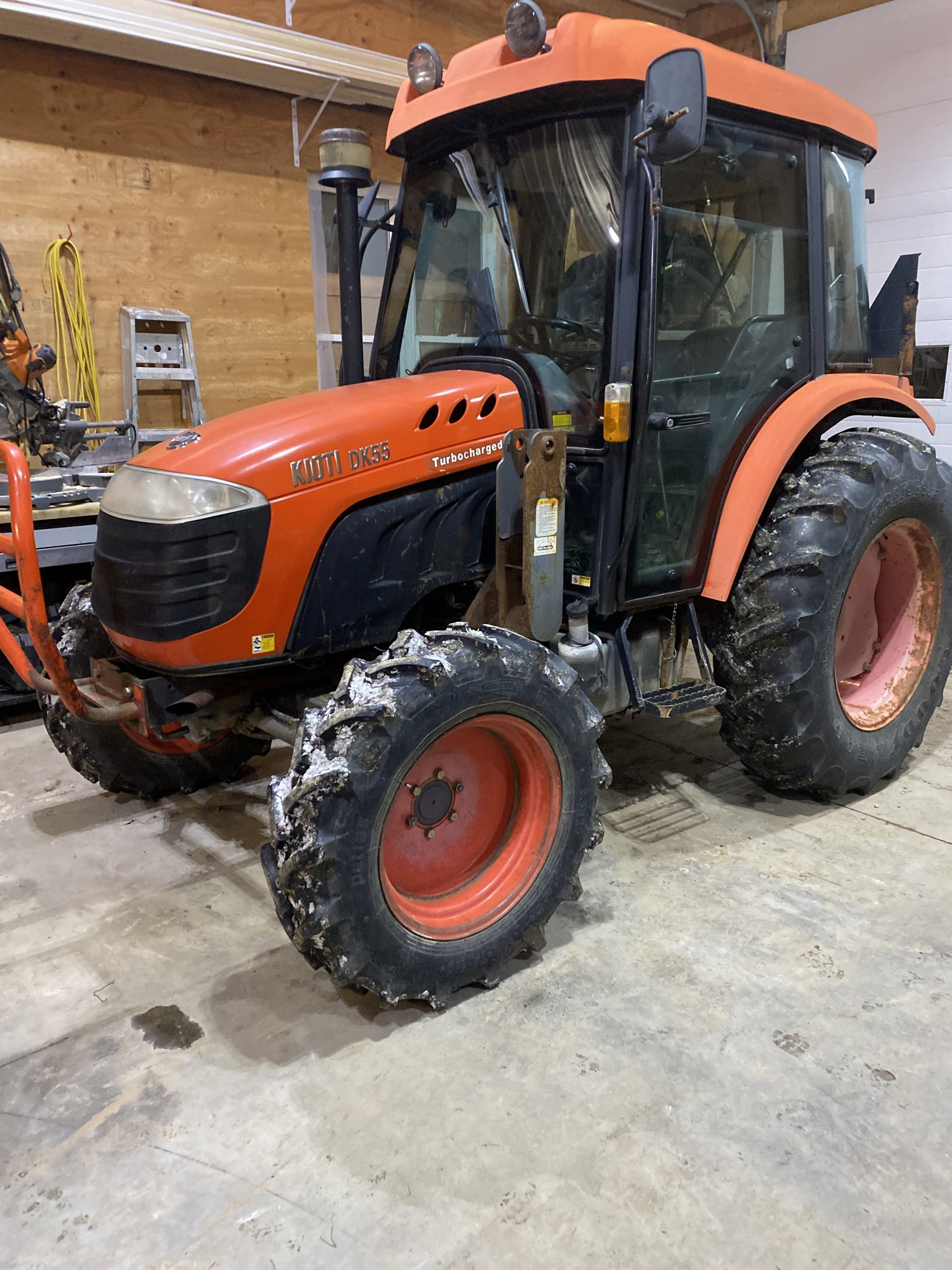

I have a kioti 55 that the engine oil is filling with diesel fuel while running
Enough that it blows out the blow by after an hour on a fresh oil change
My thoughts are injection pump leaking but how or where and is this a. Common problem
I have looked on numerous sites and forums but can’t seem to find something similar

Sounds like a bad fuel injector but I could be wrong.
   / Fuel in oil kioti dk55 #3
I believe your injection pump has a failed seal and is leaking internally. Unless you are very adept at fixing it, I'd have a dealer do it. Constantly getting diesel in the lube oil will eventually destroy the crankshaft bearings.

It could also be a failed diaphragm on the mechanical fuel lift pump, if so equipped. I would check that first since it is usually pretty easy to get at and replace or switch to an electrical lift pump.

Ended up being a. Lift pump thanks for the input
