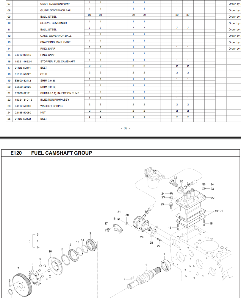

Is this the plastic gear that has been breaking?
How many CK25/30 engines have had this problem?
If they are all going to break at a few hundred hours, how many $1,200 will we need to fork out in 10 years of using our CKs? Is there anyone with Kioti that cares to reply to this post?

I think I read posted somewhere on here by a dealer that Kioti did make a design change inside the pump. Something about original design using the wrong kind of plastic that became brittle when exposed to diesel (dah!! :confused:). Time will tell. In the mean time, I've started adding lubricant to every tank of fuel.
