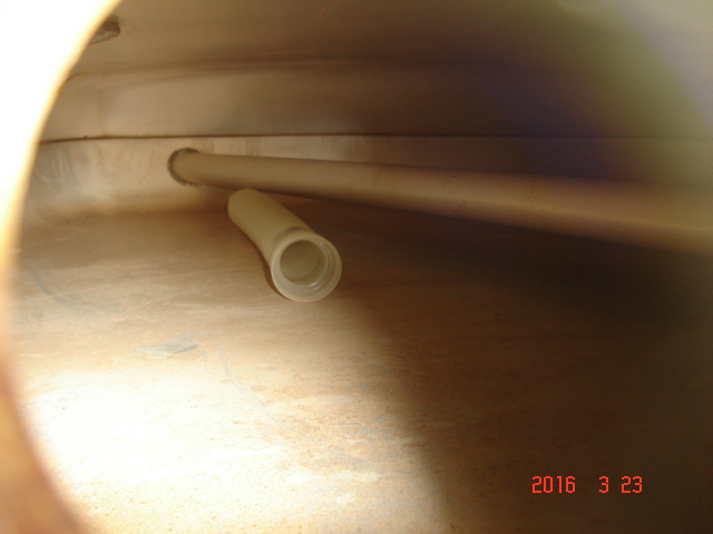

While fueling up a MF 245, the 4" plastic nozzle from a fuel container dropped into the fuel tank.
The engine hasn't been started since then.
I can't see the nozzle.
How do I get it out of there ?
Will it cause damage ?

Sounds like an issue I had (and didn't know about) on my PLANE!! WHO DROPPED IT AND WHY IN $#@ DIDN'T THEY REMOVE IT??:eek:
But no, it apparently did no damage...:cool:
Ditto on a grabber thing, unless it's steel and could be reached with a magnet, maybe.

Another vote for probably not an issue, although I am glad it is not me :) I doubt the fuel pickup is large enough to suck up that nozzle. I would use the tractor until the fuel in the tank was 1/4 or less and then you can probably see the nozzle, maybe stir the fuel around a bit to make it easier to find or reach and fish it out. Worse case scenario, remove the tank and work on it off the tractor.

I've dropped the cap on the end of the fuel nozzle into the tank on my riding mower. NO problem, straight shot down the fill pipe, I could see the little critter at the bottom of the tank, got it out with a bent coat hanger.
Now if this happened on my Kubota tractor - not so much fun. The fill pipe has two 90 degree bends, I wouldn't be able to see anything and I think I would just forget the entire situation. The fill nozzle will not hurt anything and chances are you could damage something trying to extract the nozzle.

Thanks for the replies.
Relieved it's not a problem.
I'll try using a grabber when the fuel is lower.

There are many of these fuel nozzle threads on here. It usually doesn't cause any problems, and most just stay in there and are never retrieved because of the difficulty in getting them out.

My guess is that fuel nozzle sat in my left tank for at least 7 years. Only thing it did was make a really clean spot in the aluminum under it where it rocked back & forth... but yeah, (apparently) no problem. --Hope I NEVER have to deal with an in-flight fire! Yikes!! What bothered me more was that the individual involved in my case HAD to know that was in there, and yet --again, apparently-- did nothing about it. Grrrr.
