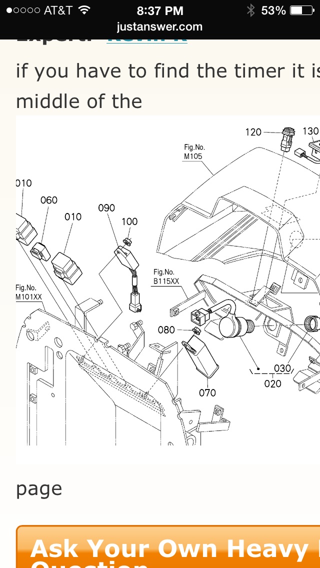

I hope I have something to give back, as I do not have a mechanical background. I appreciate any help. My current problem is with my 2005 Kubota 2800. It dies after running a few minutes, I read online on another site how to bleed the fuel injector lines, which I did, it still dies. I read last night, on another site, about the switch timer, at $75. Anyone faced this problem yet? Thanks.
   / FUEL OR SWITCH #2
Sounds as if your tractor has a fuel restriction limiting fuel flow from tank to inj pump. Is tank venting??
   / FUEL OR SWITCH
The attached shows the timer. Have you run across this fix? Also, before I bled the air I replaced the filter.
