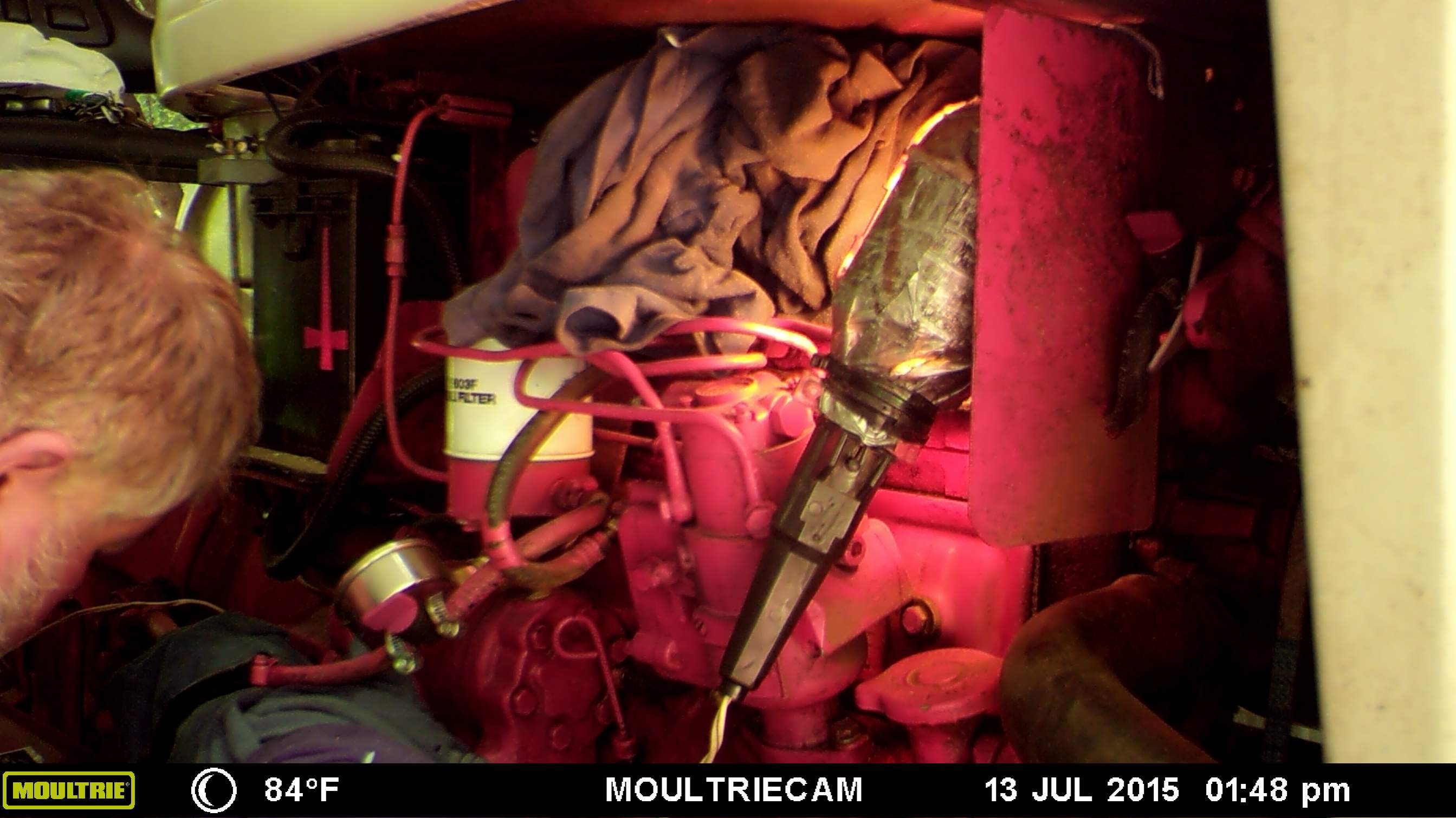

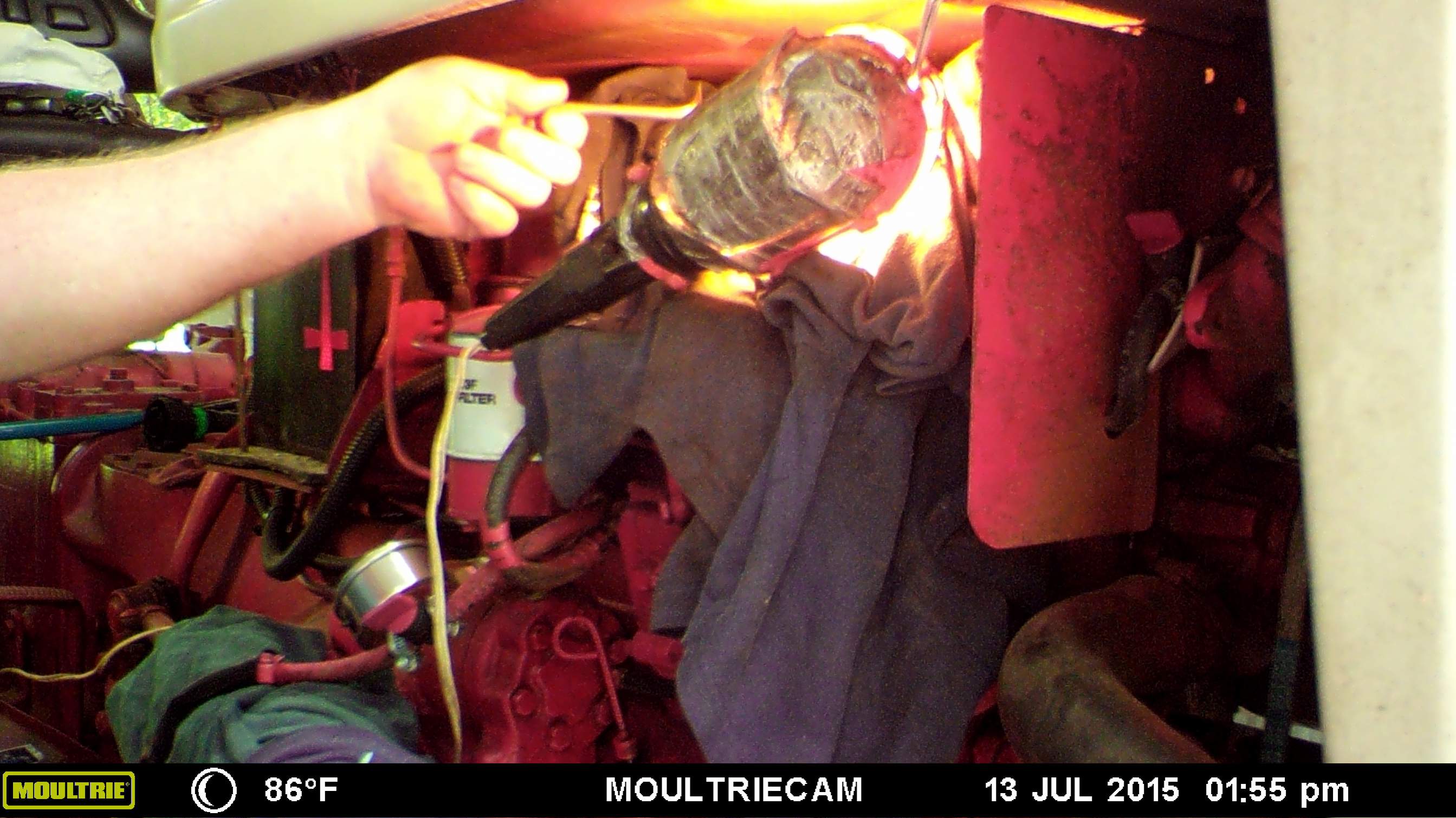

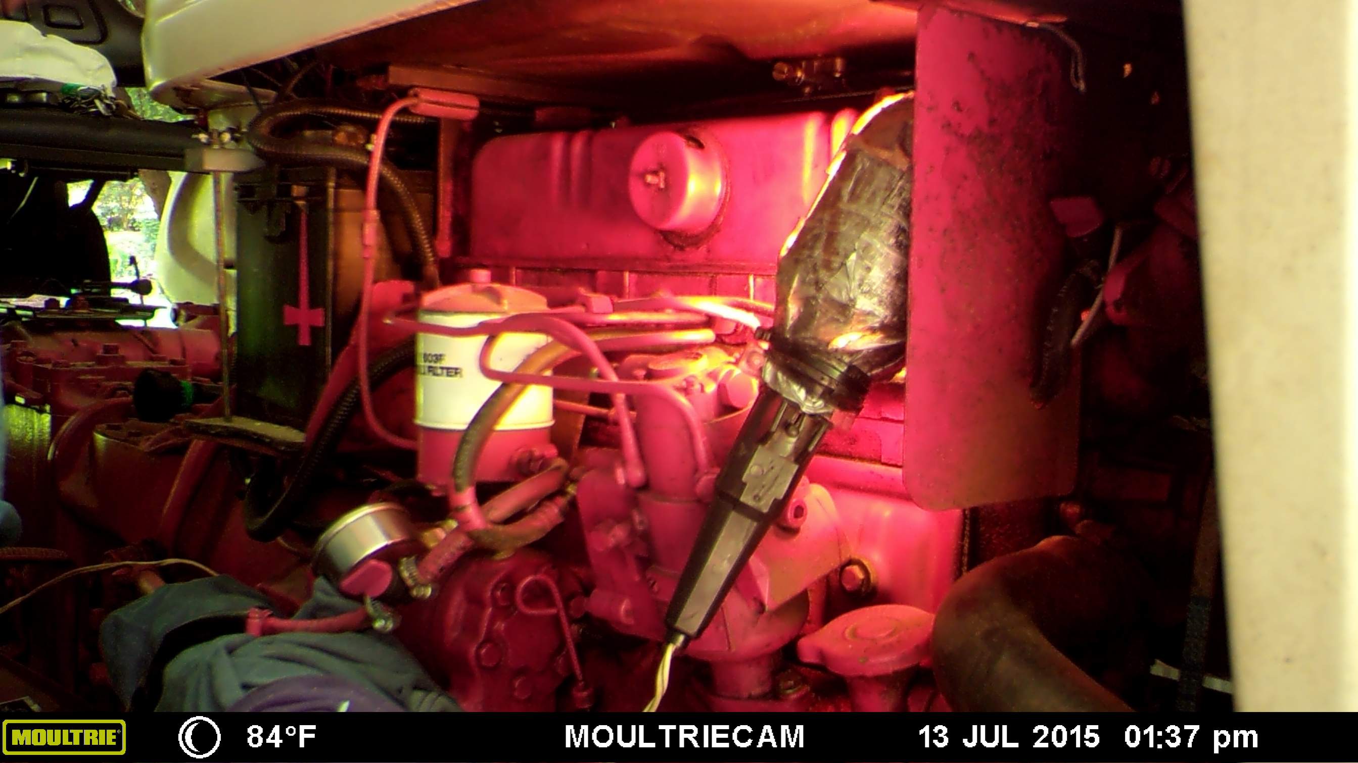

Whew! Such a simple repair that due to the location was a PITA, but I got 'er done. Draining the almost full tank took a while. The screws holding the valve to the tank on mine was slotted screws for a flat blade screwdriver. They were a pain to take out and reinstall with my little bent right angle screwdriver. Then the fuel line fitting was also a pain to get loose. No room to turn a wrench. So I waited until I had the valve loose before I could get my wrench on the fuel line. The pin did not pop out either. I had to drill out the pin, but it was soft aluminum and easy to drill. I tapped the hole and replaced the pin with a screw. Replaced the O-rings and goopped some RTV on the threads as insurance leaving the screw in the open position as the inline shut-off valve I installed earlier is easier to get to and use. By this time thunder-boomers and hail were coming down all around me under my little metal carport cover I was working under. I can't say putting the valve back on the tank was any easier than taking it off. I just got big hands and had to get some help from my wife to reach in between the valve cover and tank to get the mounting screws started.

yup, the mounting screws are a pita.
and the 2" clearance from valve cover to tank leaves little room for big hands or tools.
the line wrenches, i happen to have a flair wrench set that makes it a little easier.
