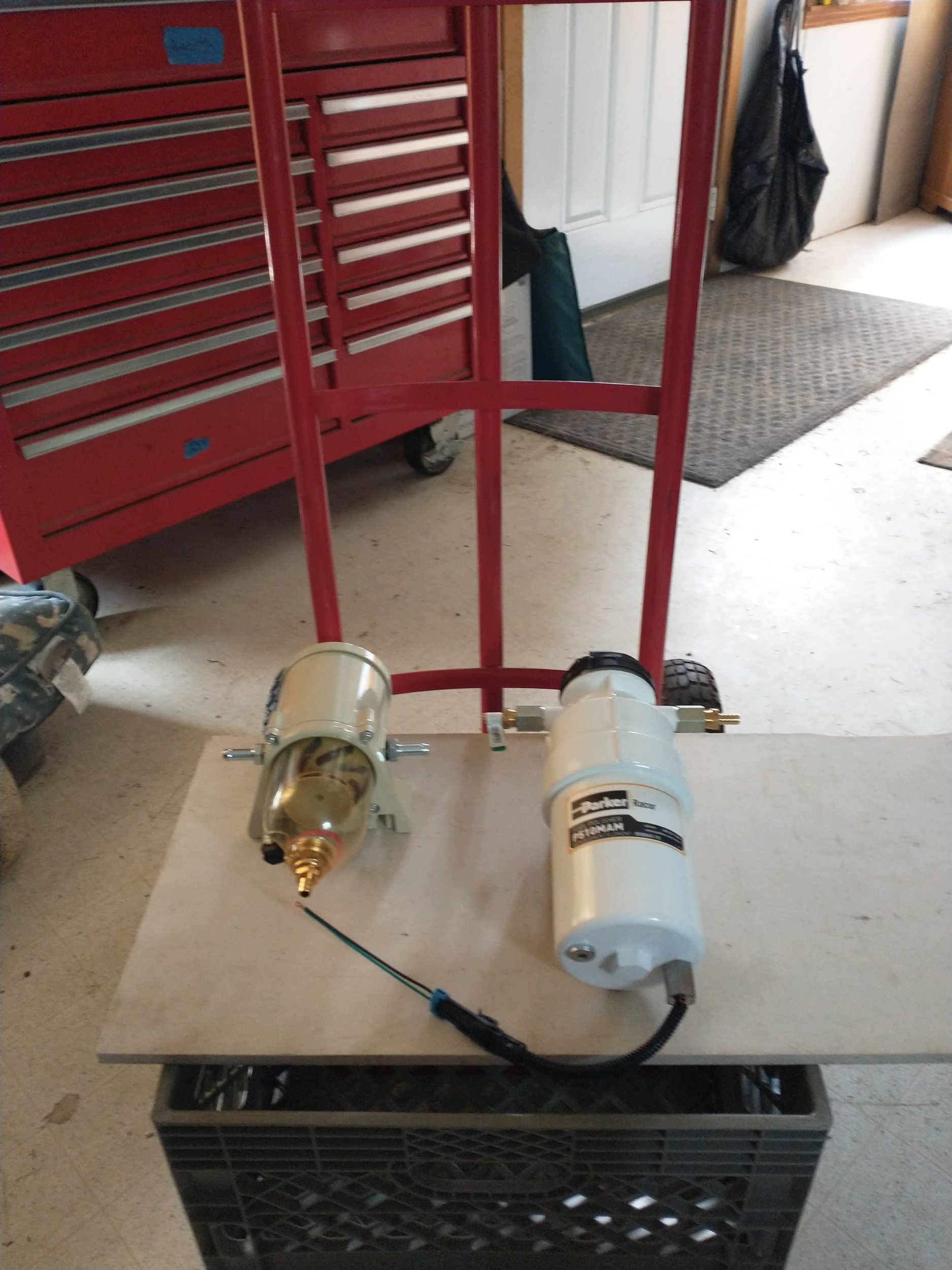

   / Fuel Polishing Needed, Portable and Value Priced
Got some 0.5" sheets of HDPE from back when I was a Striper slayer.
How about fabbing a polishing stand from this stuff?
#9
This is how it is mocked up now.
Do not really want to cut another sheet to get a 20"x20" backing.
Milk crate will hold the battery and spare filters.
1" pipe hangers will hold the milk crate and board to the 2 wheeler.
What do you think?

   / Fuel Polishing Needed, Portable and Value Priced #10
How much? I bought 2 of the Chinese bases for 50 bucks and added 4 Racor filters (2 used and 2 spares) for 100 bucks from the Racor store. Mine are tractor mounted however.
