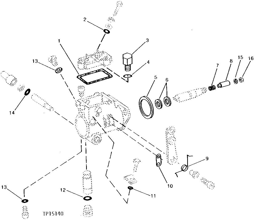

I have a JD 410C backhoe that seems to have a fuel flow problem. I tried to start it and even though it was cold it seemed to take longer than usual to start, when it finally started it idled around 1,000 RPM and ran fine but it would not throttle up (even at full throttle it stayed at idle) I then shut the machine off and checked the throttle linkages and found no problems. I came back to the machine a few days later and started it again it was running on all cylinders but was surging between 500-600 RPMs then it stalled (start it again and it would do the same- then stall in a few seconds) My question is how would I tell if the lift pump was bad or if the injection pump was the problem? the lift pumps looks like it has been replaced recently but I have not replaced it so I don't know for sure. also the fuel filter has been changed

For the ones I've seen if the lift pump is bad they feel limp when you operate them manually.
It sounds to me more like a fuel restriction. Have you changed the filters lately? Is it cold enough to gel up?
Make sure you are getting fuel to the lift pump by loosening the line coming from the tank. Fuel should flow freely.
If you are then make sure you are getting fuel to the injection pump by loosening the line coming from the lift pump and working the lift pump by hand.

While engine is running is fuel flowing out of fuel return line located in the fuel tank neck?

Tx Jim - I'm not sure about that, I can't seem to keep the engine running long enough to get out of the cab and check. Only runs for a few seconds and then dies
Loosen the 2 screws holding the cover that is sealed by gasket(parts key#10) then pry gasket loose on the side of IP. A little fuel will leak out. Now try to crank engine. If it runs longer than a few seconds then fuel return line or check valve that fuel return line attaches at inj pump is stopped up.

thanks Tx Jim I will try that tomorrow. Just one question, is the gasket/cover on the side of the IP that faces out or is it facing toward the block? its kind of hard to tell from the diagram.
