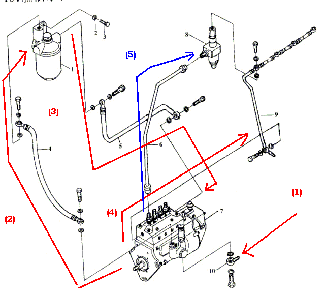

I have a Jinma 180 that dates back to 1996. It ran fine until last week. I increased the engine RPM's and the engine just lost power and died. It was low on fuel so I put in more fuel. It tried to crank but didn't. Starting fluid started the motor until it ran out. I have checked the fuel to the injector pump from the tank and have a good flow. I'm waiting on fuel filters to arrive to change them. Is there anything else I can check that may be the problem? This is the first fuel problem I've had since I bought the tractor new 8 years ago. I don't ever recall the filters being replaced so that's my starting point.

Sounds like air lock in the hard lines between the injector pump and the injectors. The hand (priming) pump will only get fuel TO the injection pump, not through it. It's a little confusing, because the fuel pump and injection pump are actually two halves of a single unit. The fuel flow is; tank > sediment bowl > fuel pump > fuel filter > injection pump > injectors.
Locate the line between the fuel filter housing and the injection pump. Loosen the banjo bolt at the pump end. Prime with the hand pump till bubbles around the loosened banjo bolt change to a steady fuel flow. Tighten the banjo bolt, screw down the primer pump.
Use a line wrench to loosen the hard lines at the top - the injector end. Half a turn is usually enough. Now crank the engine till escaping bubbles turn to fuel flow. Unlike the steady flow you observed below, the flow into the injectors is intermittent. This is normal. Tighten down the hard lines, start the tractor with your usual procedure.

I wanted to chime in here, priming these engines is a pain! I pumped for at least an hour and still had an air lock, I finally solved it by cracking all fittings one by one and pumping as each fitting was cracked. My air lock was on last fitting before the hard lines, you can hear air escaping.

If I understand you correctly, the last fitting before the hardlines is the banjo fitting on the injection pump end of the fuel filter hose. When fuel is hand-pumped to that point, it should bypass the injection pump and flow back into the tank via the bypass line. An air lock at that location suggests a blocked bypass hose line.
See the attached diagram. Red 1-4 represent low pressure fuel flow when the hand primer pump is used.
1 - fuel tank to fuel pump
2 - fuel pump to fuel filter
3 - fuel filter to injection pump
4 - injection pump bypass line (back to fuel tank)
Once the injection pump HAS fuel, it pressurizes it and sends timed spurts up the hardlines (blue 5).
So when the tractor is not running and the hand primer is used, the fuel flow is Red 1-2-3-4. When the tractor is running, the fuel flow is Red 1-2-3>Blue 5, with excess fuel returning to the tank via Red 4.
That help?
//greg//
   / Fuel Problem???
Well I got my filters in and replaced them as well as replacing one of the fuel lines. It finally cranked up after using ether and running all of the air out of the lines until it ran by itself with a load on the engine. It cranked up fine six straight times after I initially got it going again. My primer is froze up and won't pump. Has anyone had any experience with this problem and is there a way to free it up without taking the pump apart to do it? The filter was the original so it was pretty torn up and the primer has only been used when the tractor was new in 1996. I also have a very slight leak in the injector but it's just dripping now. After losing 2 gallons of diesel in a pan, I found that the nut on the bottom had worked loose and it was losing diesel.
