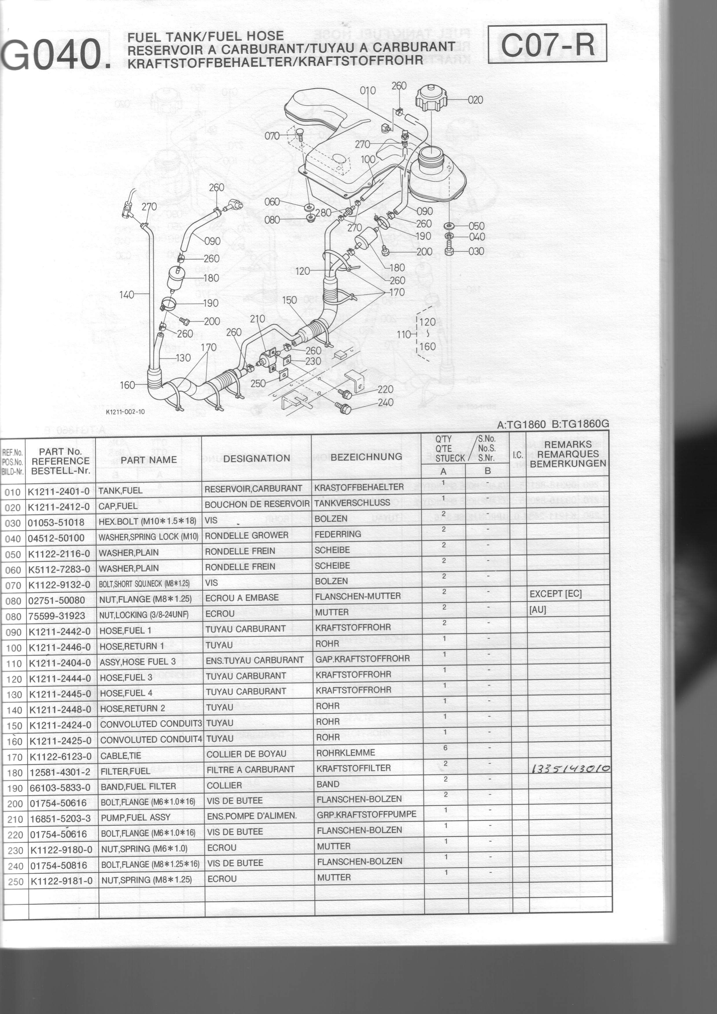

this what you're looking for ???
item 210, p/n 16851-5203-3

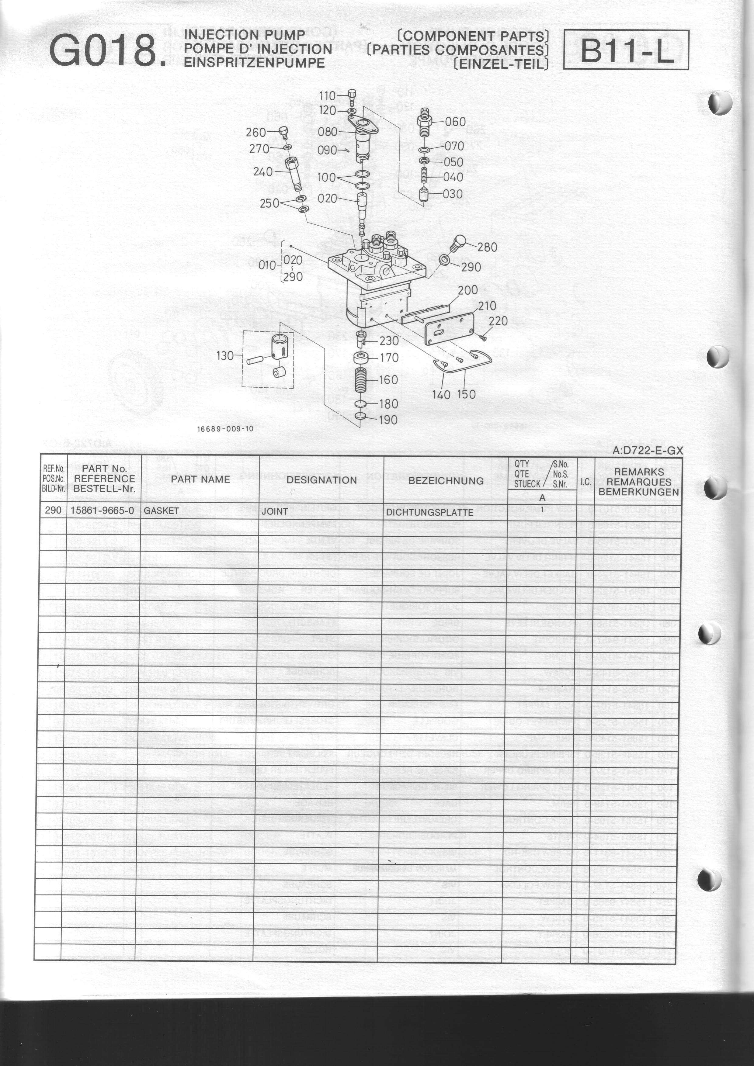

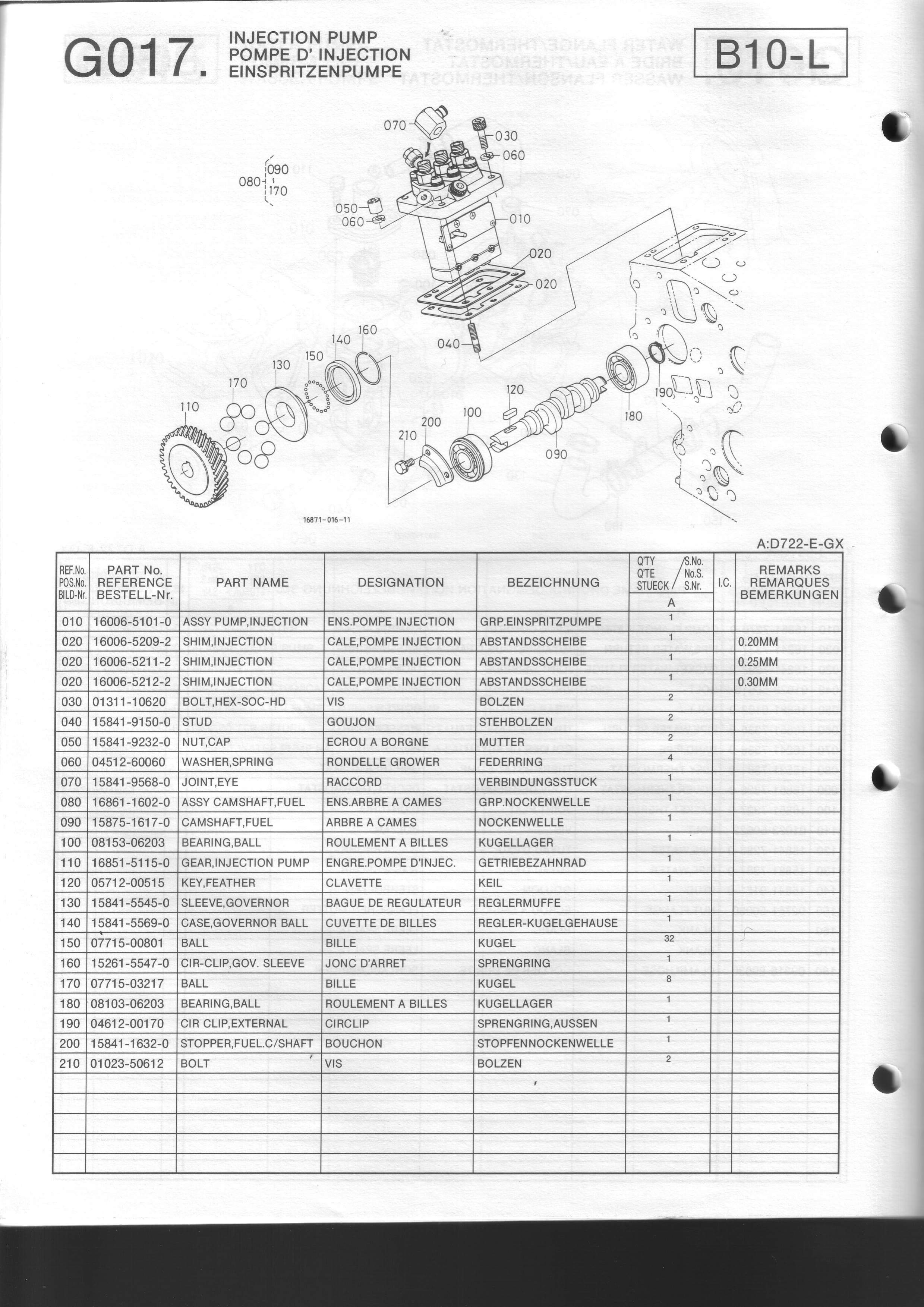

I'm looking for a parts view of the fuel injector pump (diesel)
   / Fuel pump not pumping diesel on Kubota TG1860 #4
OK, you did say fuel pump in your post, but let's try these...
I guess my mind reading skills are lacking...:laughing:
Pete

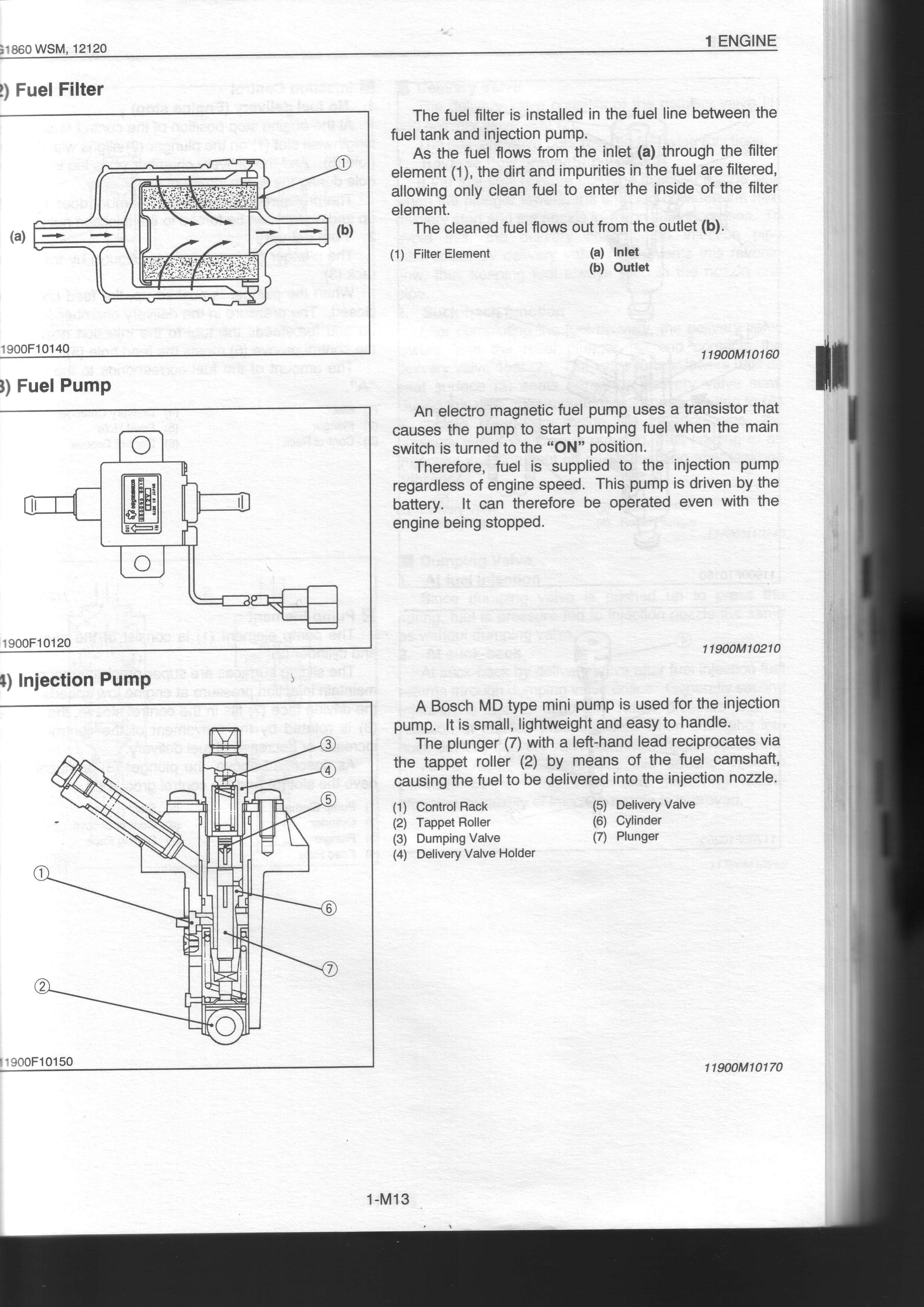

Chris... have you verified that the electric fuel pump is delivering fuel to the injection pump ?
ie. with the fuel hose disconnected at the second fuel filter area, with the key on, you should have fuel flow, IMO. I'm not sure the injection pump is supposed to 'suck' fuel from the tank.

This model has a mechanical pump. No electric pump.
From what I've read, IMO there IS an electric fuel pump... the item referenced in my first post.
Unless your TG1860 is unique.
If the pump is working, other commom problems are debris blocking the opening in the bottom of the tank, and a blocked vent orifice in the fuel tank cap not letting air in to the tank.

here is a page from the TG1860 WSM, showing an electric fuel pump does exist.
