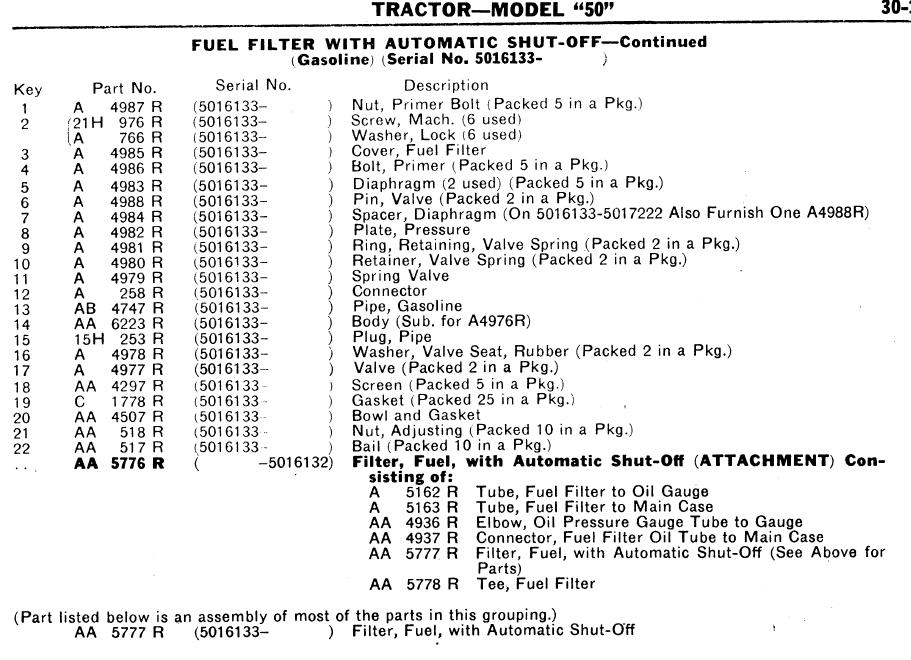

I have a John Deere 50 with the auto fuel shut off. I noticed oil leaking from around it but I don't know if there is a gasket in there or not. Help please!

Had to take a second look.
First is showing the fuel filter, but don't see specifically the shut-off parts/oil lines.
Second is the parts list that lists the parts with lines. Appears the lines would just be copper tubing with flare compression fittings.

Thanks! This helps a lot, where did you get the diagram?
   / Fuel shut off question #4
Go to jdparts, and sign in (free registration).
Search on model number and all the parts by category will load for you to search around.
