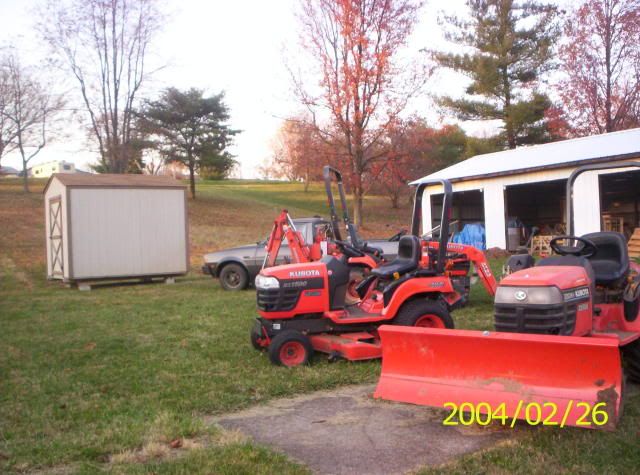

1*That's why I moved my set up out of this carport
http://i283.photobucket.com/albums/kk286/lb59/photos034.jpg
into this 8x10 storage building.http://i283.photobucket.com/albums/kk286/lb59/100_2550.jpg?t=1229354830
