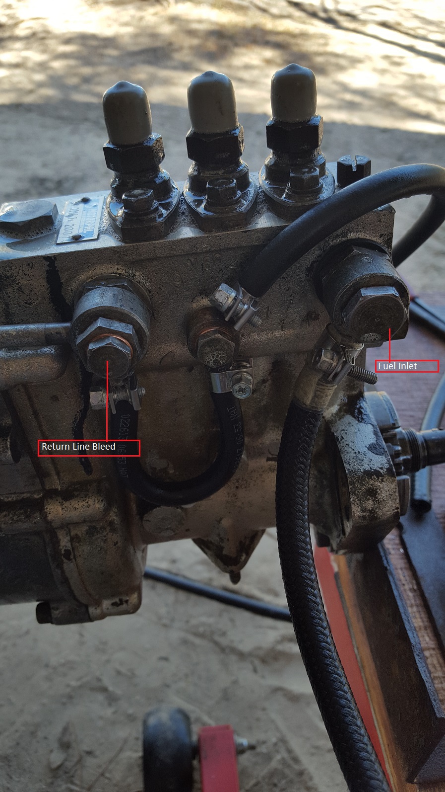

   / Fuel System Help with Zetor 5211 #4
the 5211 came stock with a screen filter on the fuel pump, a primary and secondary fuel filter, "so" three should be serviced.
bleed the air from the fuel system all the way to the injection pump fuel inlet @ the backside of the injection pump,
then bleed the air from the injector pump at the fuel return line bleed, this will remove the airlock in the injection pump,
then loosen all three hard lines at the injectors, bleed the air from all the lines @ injectors, the engine should start.
