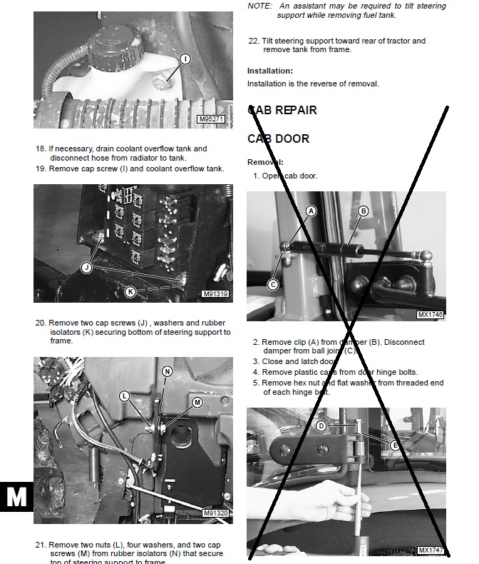

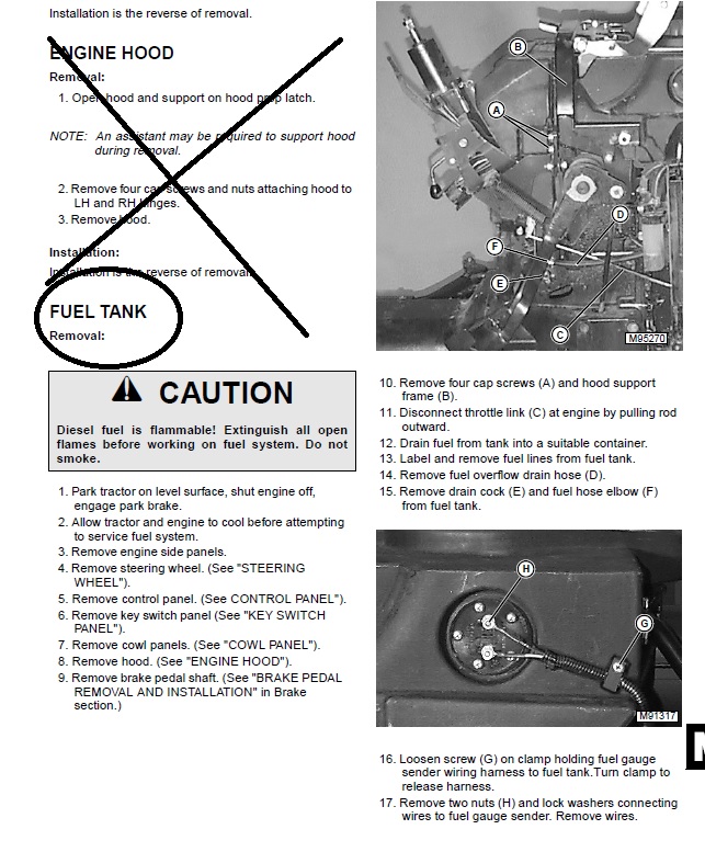

Feb 13, 2018 / Fuel tank removal #4 B beenthere Super Star Member Joined Aug 16, 2001 Messages 18,519 Location Southern Wisconsin, USA Tractor JD_4x2_Gator, JD_4300, JD_425, JD_455 AWS, added JD_455, JD_110, JD_X485(sold) Maybe these two pages from the service tech manual will help.. Attachments 4300_fuel_tank_removal 1of2.jpg 191.8 KB · Views: 507 4300_fuel_tank_removal 2of2.jpg 200.5 KB · Views: 439
