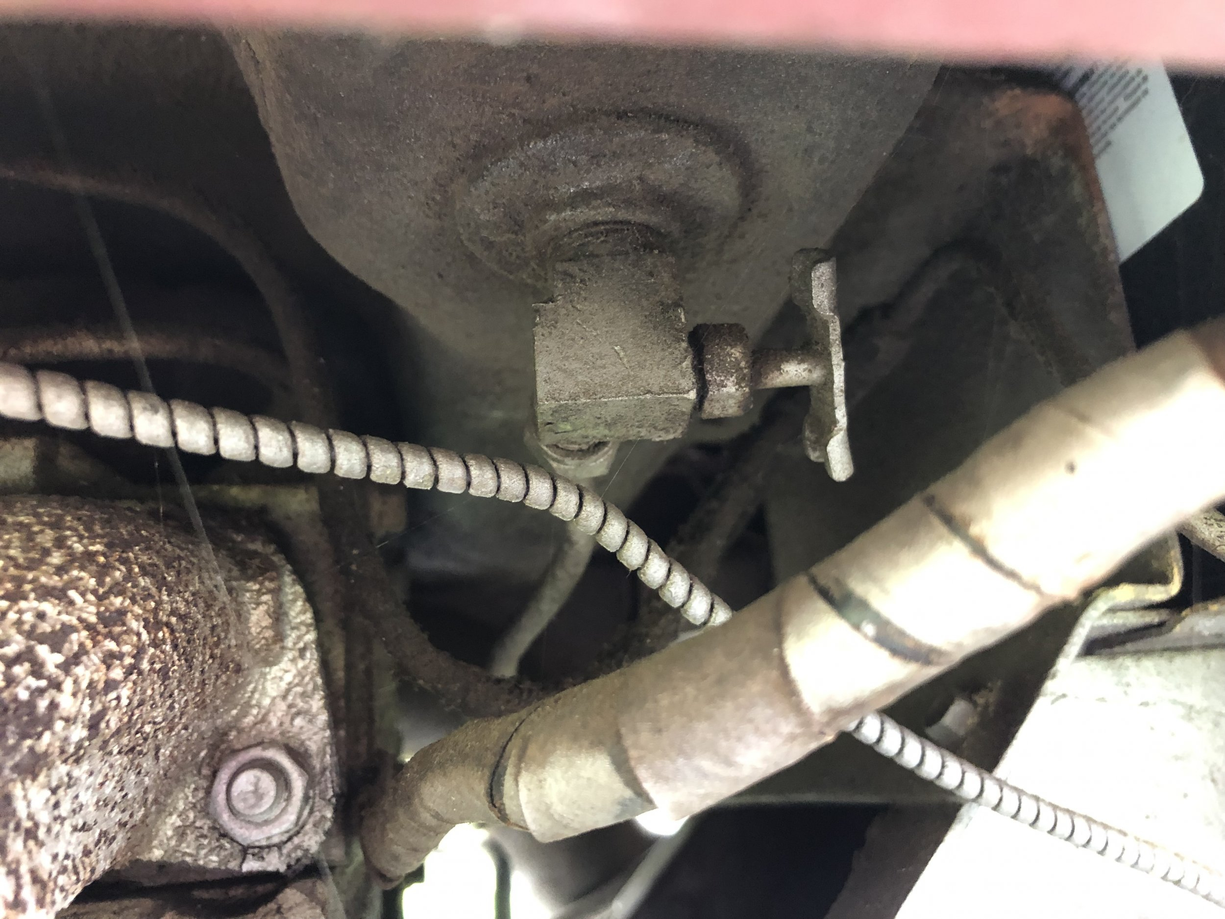

I am looking to replace the fuel tank on my 1975 MF 135 with the Perkins diesel. It’s pretty rusty on the inside and clogging the lines and fuel filter. Has anyone done this and found a reliable source? I’m mostly concerned with getting a quality tank that will be a simple swap out.

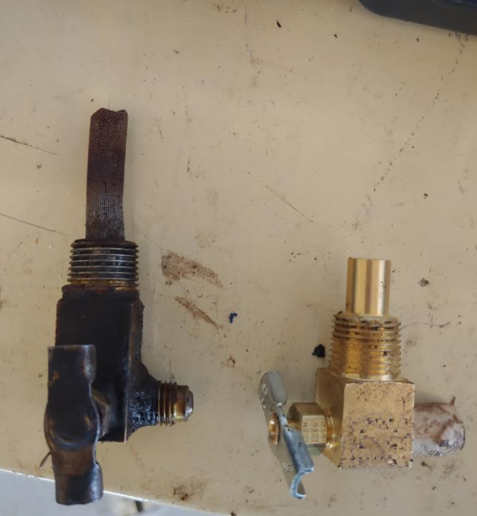

Do you have the strainer on top of your fuel shot off valve? Often this is missing and everything gets filled with junk.
   / Fuel tank replacement for a MF 135
I can’t tell. Would the strainer be up inside the tank? See photo below.
Thanks
   / Fuel tank replacement for a MF 135 #4
Something like this
   / Fuel tank replacement for a MF 135 #5
You can not see the filter when installed in the tank. You need to remove the fuel shut off tap from the tank to see. A bucket, funnel and hose will be needed to catch the fuel. Run the fuel down first.
I had a similar crud in tank problem, but was not prepared to dump a good tank.
The fuel shut off tap and the fuel filler opening both have a lip the prevents removal of crud.

The tap can be ordered from Agco as well. The new tap does NOT have a filter screen. It has a raised lip to prevent junk from getting into the fuel lines.
