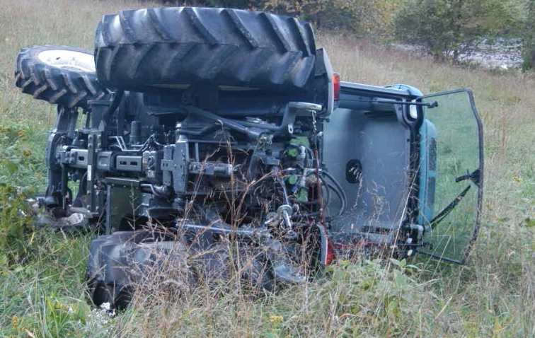

Does anyone have an idea why for the last several mos I cannot get my almost 14 gal diesel tank to go more than 5-7 gals before the gauge shows MT? I know there are 2 (connected) fuel tanks, one in front of the radiator (where the filler neck is) and the other below the cab floor (out of which I can see that lines run to and from the fuel pump).
An obvious gauge problem? Let me tell you about my onsite service bill around November 2004 for purging and restarting my blue wonder. I tried to test the gauge and ran out so solidly that serviceman Joe had to loosen the injector lines after I had vainly used the hand operated purge pump on the filter. So the gauge apparently works at the MT end. But get this-- though it appeared to take a long time to clear the final empty block compared to how fast it went down from half full--"half full" oddly is what it reads when I fill that front tank to the top. It has not "read" above half for about a year.
FYI, I had an overturn in October (see attached) and my machine went in to the dealer for check out. He charged me for over 10 hrs and a new battery that was not installed. Of course I wonder if they missed a pinched somethingoranother, etc. But since fuel is going in one tank and appears to be regularly coming out of the other one (going to the fuel pump), how can that be?
For now I just keep putting in 5 or so gals at a time, a pain while ranging out in the fields (totaling 80 acres in hay) cutting, baling, etc.

You didn't exactly say this, but it sounds like the fuel gauge hasn't worked correctly since the roll-over. Is this true?
Also, I think what you're saying is that the fuel capacity has never changed, only the fuel gauge reading has.
Is it possible that you in fact have two fuel level sensors (one for each tank) that are somehow tied together to show you the total amount of fuel in both tanks with only one gauge? Seems like this is the only way it would work or the gauge would show completely empty when the top tank runs out or completely full until the front tank runs out. You might check your owner's manual and look at the electrical schematic and see if you have something like this. If so, then maybe a wire fell off of the front tank or shorted to something else in the roll-over.
Maybe in the rollover, some kind of float in the front tank got stuck. If you happen to find that you have wires coming from each tank(i.e. two sensors) you might try swapping where they connect and see what the gauge does when you refill the tank. If the front tank is out, and you swap the wires, then you shouldn't see any gauge movement till you fill up the lower tank.

Did some testing today with former NH dealer service mgr helping: with the front (upper) tank almost full, it read about 13 ohms on the sender with wires disconnected. On the rear (lower) tank, which should be full while there is anything in the upper tank, it reads 150 ohms. HB tells me that lower readings mean less fuel in the tank, so the rear/lower reading is obvioulsy wrong! I'm writing the NH service rep for help (dealer did not have a solution). It may be the sending unit in that tank, but that means I have to run it out to prove that only the gauge is wrong.

Ok, if lower ohm reading means less fuel....
Lower tank reads 150 ohms when full. That makes sense compared to the following...
Upper tank reads 13 ohms when full. So Upper tank sensor is stuck at the 'empty' position or something....If it is the same sensor as the lower tank, it should read aprox 150 ohms when full.
So the gauge reads 300 ohms of resistance across both sensors = full tanks.
What you are seeing as the half tank on the gauge does make sense here, one tank is showing full on the sensor, the other is showing empty.
That scenario would make the gauge read empty when they are both empty, the gauge would start dropping as the bottom tank empties out as it has a working sensor along with the upper tank being already empty which is what it's defective sensor has been showing anyhow.
The sensor in the upper tank needs to be checked imo, maybe remove it and check to see if the float is stuck/defective or something.
