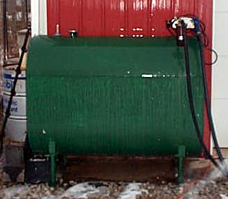

Tuthill makes a good pump. Contrary to what Richard says or maybe I should say, in addition to what Richard says, No matter which manufacturer you get the pump from, the water seperator/filter is not included. It's purchased seperatly. I have a GPI (Great Plains Industries) pump on my bulk tank and a Tuthill (just like the one in the picture) on my transfer tank that goes in my picyup. The GPI pump does have a mesh strainer in the pump body, It would stop bugs from getting in the fuel line but that's about it!! I've included a photo of my bulk tank. You can see the add on filter/seperator. It's a GPI unit too. I use the more expensive water seperator/filter cartridge.

I should probably mention that I have automatic shutoff nozzles on both pumps. It makes it easier to fill tractors when you don't have to watch to see if you are going to overflow the tank and run the diesel all over the hood!!!
