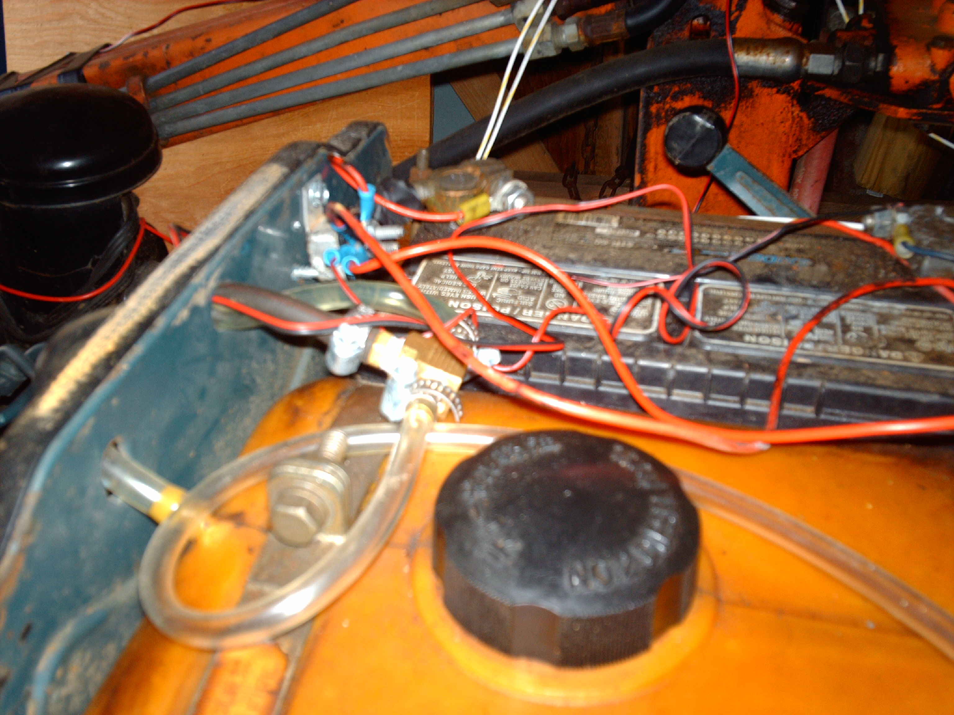

Hi all,
I did a search to see if I could find this out, but the only thread that came close kinda drifted away from fuel use into hour meter theory...
Anyway, I'm wondering if any B7100 owners out there can give me an estimate as to how long I'll be able to run mine before worrying about checking the fuel tank.
I guestimate that most of my use initially will be mowing with a 60" MMM, but I also have a 12" plow that I'm working on, and expect to be dragging around some downed trees, among other things.
My property is about an hour's drive from home, I don't feel comfortable leaving my tractor out there if I run it out of fuel by accident, and I'm pretty certain I won't be able to push it back onto the trailer.
So, can anyone ease my mind? I sure don't want to be stopping every half hour, or worse yet stopping the wife or daughter, to check fuel level.
Or has anyone come up with a way to gauge the fuel in the tank? Mine is pretty opaque, guessing from age, so I really can't judge visually.
Thanks!
Jim

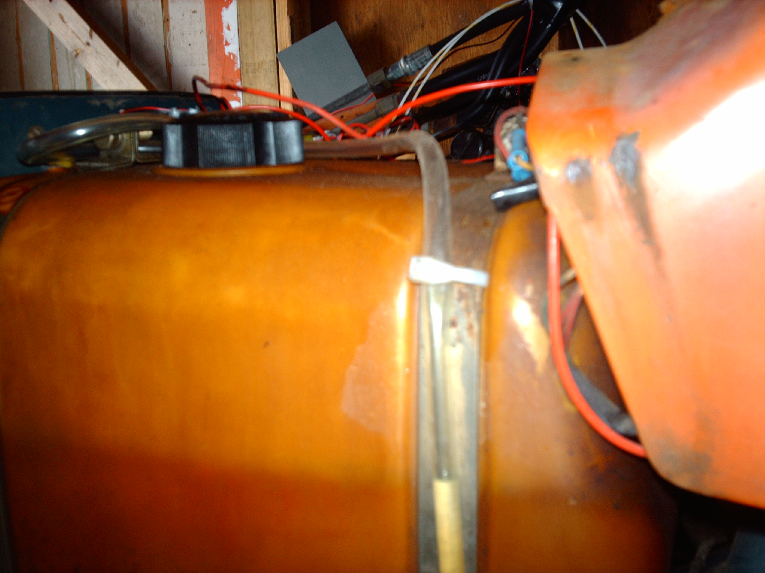

I am not sure about hours of usage till empty. I have a B7100 gear drive. I don't use it for extended periods of time at high RPM like you would with a mower or bush hog. When I use the backhoe it runs just above idle and I can run most all day on a tank of fuel. I had the same problem seeing the fuel level in the tank that I solved quite easily. I bought a two foot piece of clear fuel line and two "T" fittings. I cut into the fuel line where it leaves the bottom of the tank and inserted one of the "T" fittings. Then I ran the clear fuel line up the outside of the tank and cut the other "T" fitting into the return line from the injectors at the top of the tank. Now all I need to do is to look at the clear line running up the side of the tank to tell how much fuel I have left.

Thanks B2400, hopefully mine will be similar.
KubotaSam, that's a great idea for the "sight glass" made with clear tubing. I have been considering replacing all my hoses with Viton hoses, to make sure there'll be no issues with biodiesel. Maybe this will be a good time to add a gauge such as yours.
