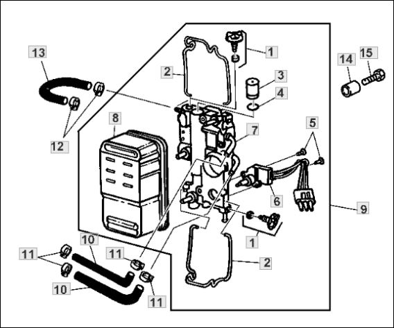

My JD F-935 has a canister water separator with a drain valve. Also handy when I carelessly run out of fuel and can bleed out the fuel line all the way up to the injection pump.
