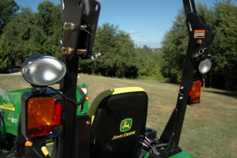

Picture of 2 worklights installed facing the rear on my 2320. They are mounted to the brushguards. The dealer did the install. All JD parts.

It's not alternator capacity I think it simply has to do with the mounts and/or the factory wiring connectors. On each of my brush guards you can only mount a single light, forward facing or rearward facing.
I have a 2305 and put on the front lights on the brush guards. I then welded a tab to the top of my tops on the rear and mounted a 55watt rear facing work light. Ran the wire through the rops (folding) and hooked it up to the work light harness. I actually like the high position much better as it lets me light 'down' on the work rather than just light up the implement I have hooked up.
No problems at all with the 20 amp alternator.
Also, the work lights hook up to the tail light harness so they are on all the time when the lights are on. If you hook up to the work light harness it will go off when the flashers are on. (I think so you don't blind folks behind you if you were on the road).

I installed the JD lights on my ROPS and just turned one forward and one back gives you plenty of light , i tend to look to my left so i used the left light as a back up light seems to work real well and i dont get blinded when i look back
