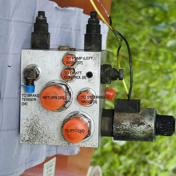

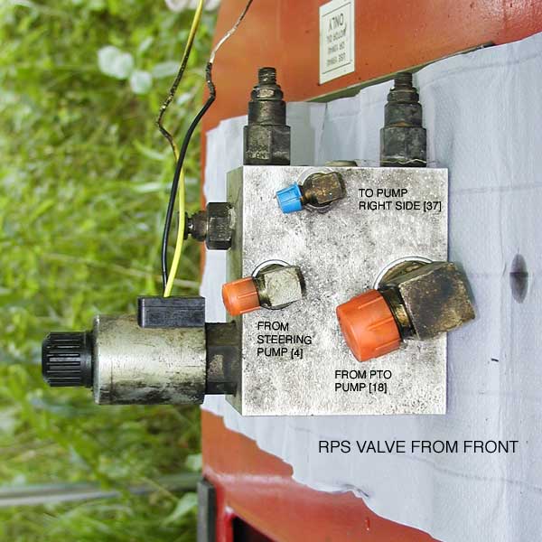

Could you explain what RPS means, and what it does.
   / Funny Search Results #10
I have no idea what RPS means. And your guess is as good as mine about what all goes on in there. Aside from that danged shuttle valve function I've managed to cross paths with ( http://www.coxontool.com/index.php/PowerTrac/ShuttleBall ) it looks like there's a couple or three pressure relief valves, the PTO solenoid, and several internal passageways directing fluid here and there. I do know from my unhappy shuttle valve experience that when it isn't working right there is a loss of draft control and wheel motor torque. As you tram back and forth the shuttle valve supplies a constant flow of oil to the draft control and brake tender alternately from the left and right side of the tram pump (the ball slams back and forth between the fittings acting as a check valve in whichever line is not pressurized at the moment).
