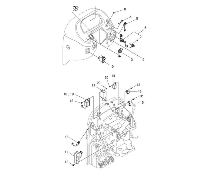

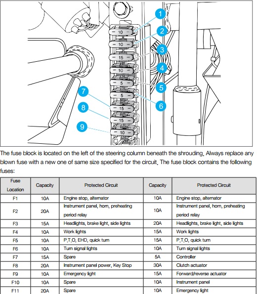

The headlights went out while plowing snow the other night. Anyone know where the fuse box is located? My manual is 200km away at my house! Thank goodness I had installed some led lights on he rops! Thanks.
   / Fuse box location 4047? #2
You'll need to remove the LH Dash Cowl, simply unscrew the (2) Bolts holding the panel on - there are round plastic grips that you can loosen by hand (unless Paul Bunyan tightened them @ the factory!) You will then be able to see the Fuse Box (#11 in one of the attached diagrams), simply remove the cover and you can go from there. I've also attached a reference chart for what function each fuse is related to.
