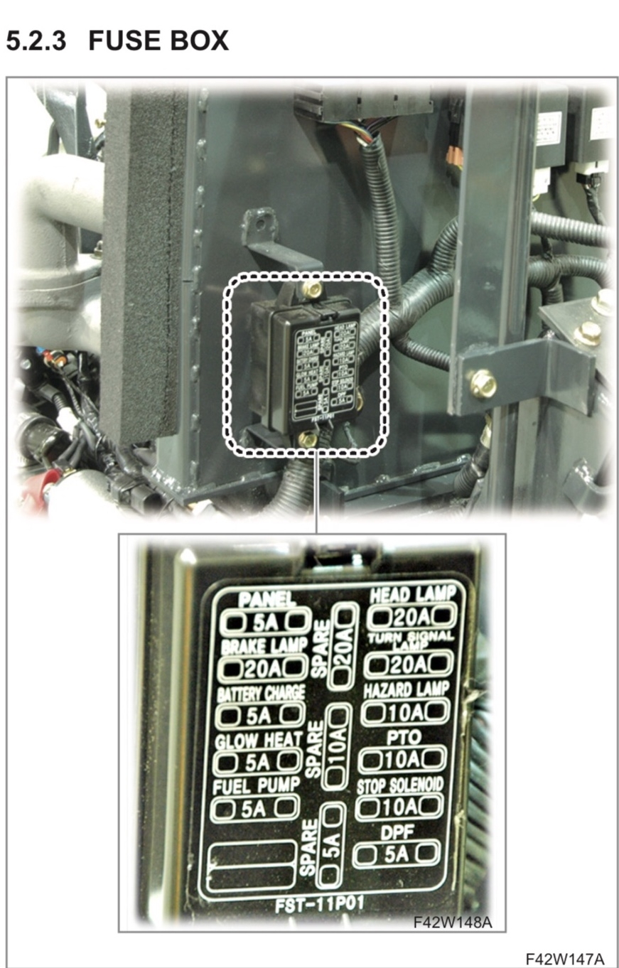

Aug 22, 2023 / Fuse Panel Fuses #1 Sooner79 New member Joined Apr 1, 2021 Messages 20 Location Far North Texas Tractor Branson 2515H I assume Branson uses automotive blade type fuses but are they mini or standard size? I don’t want to have to take off the dash panels to get to the fuse box to find out if someone here can tell me. Thanks!
Aug 22, 2023 / Fuse Panel Fuses #2 L LuckiestManInIdaho New member Joined Oct 28, 2021 Messages 6 Tractor Branson 2515R Mine are standard size blade type fuses - not the mini ones. My tractor is a 2515R purchased and picked up in May of 2021.
Aug 23, 2023 / Fuse Panel Fuses #3 A Asteral Gold Member Joined Feb 27, 2019 Messages 441 Location Caddo Mills, Tx Tractor LS TRACTORS standard blade fuses, i don't think any of them have mini fuses in those fuse boxes
