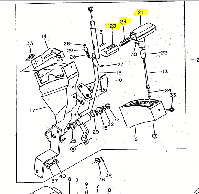

I've been looking all over for a part number for the shift lever/handle on my FX22D.
The other day while out mowing my field, the button popped out at some point and I haven't been able to find it. Any idea on where to either get a whole new handle or just that button?

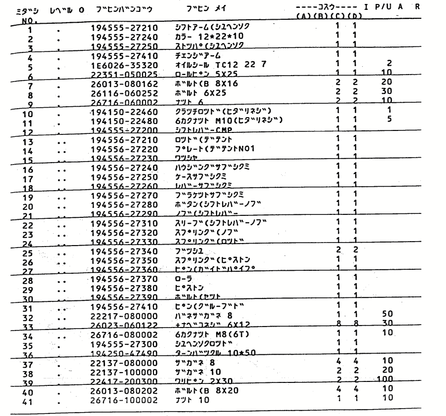

Something like this in the Parts Manual then, (y)
   / FX22D Shift handle
That’s it! Thank you!

Do you think that lever comes complete with parts 20 and 23?
Your machine is Gray Market. Best to reach out to these places first. The parts you are looking for will not be listed on their websites, so call.
