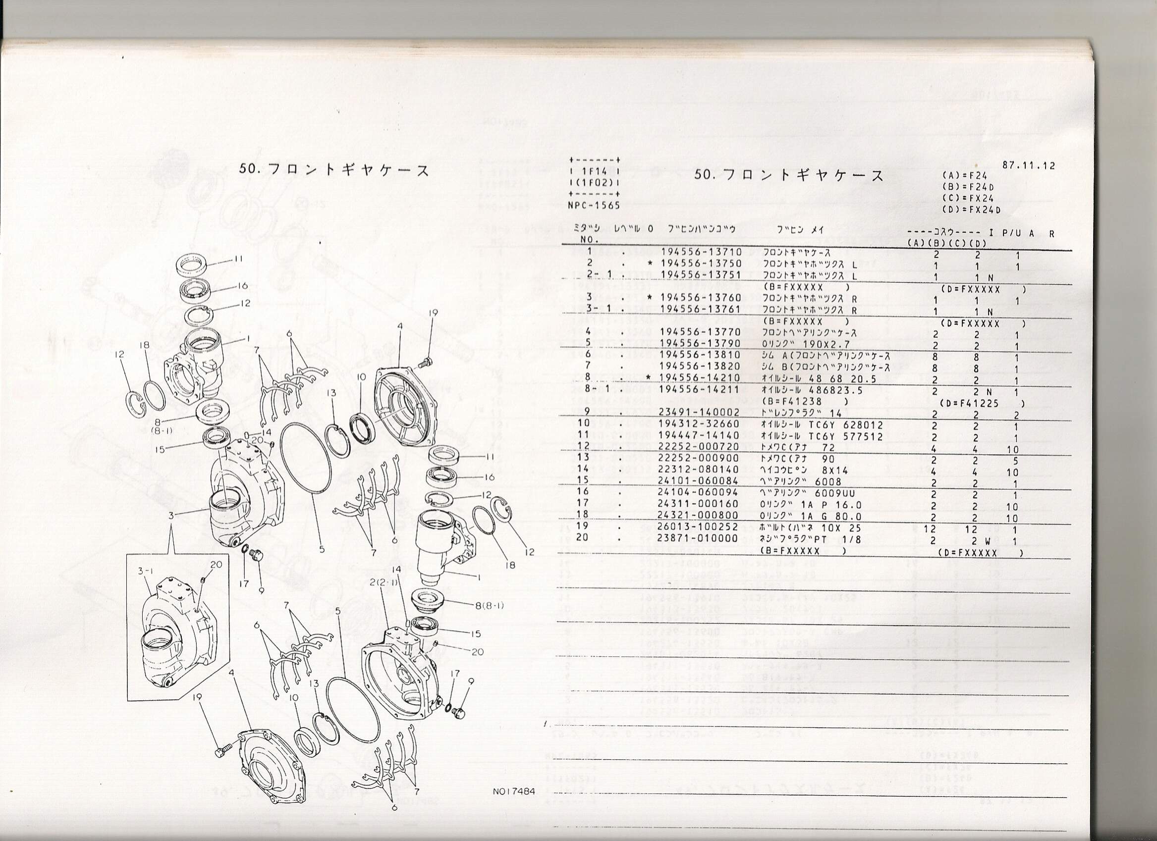

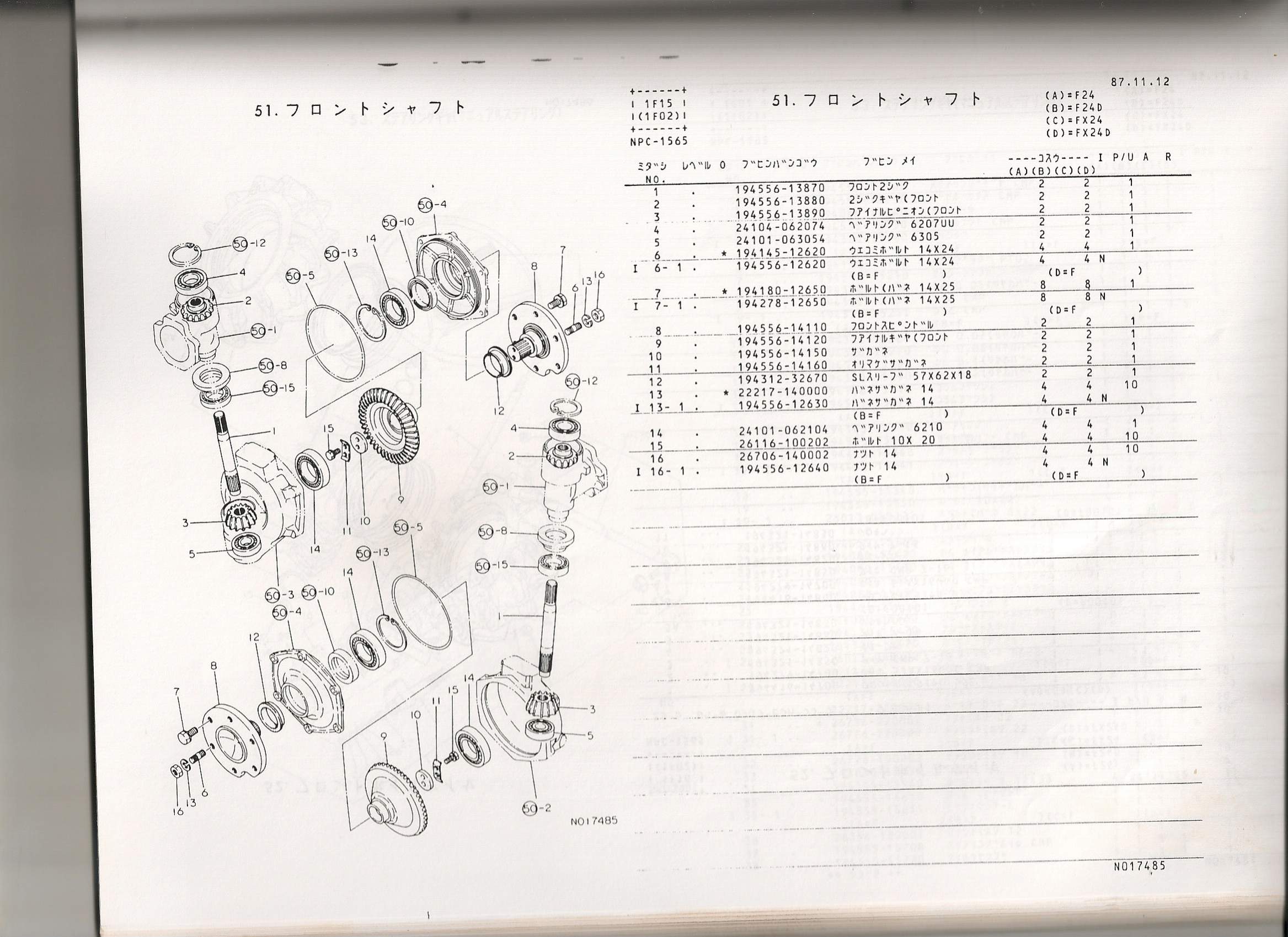

I have a Yanmar FX24D and need help finding upper front drive spindle gear, bearing and seal. Anyone know of a resource for these parts?

Welcom to the forum. :welcome: Not referencing the part numbers I assume you don't have the part numbers. Maybe this can help you. I would start with Hoye. The gear may be hard to come by.

Thanks, I tried Hoye ... no luck.
Fredericks (boneyard type place) had one on a tractor. Great service and took great care to help me out.

I'm sure Fredricks does have a bone yard but they are the only authorized dealership that brings in the greys (such as you FX24D) and completely refurbishes them. Good to hear they did you right.
