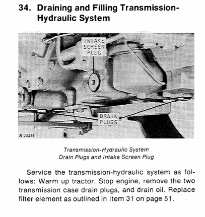

When you had fluid drained did you also clean the transmission screen? It might seem expensive but as you found out OEM fluid should be used especially in the hydraulic systems.
   / FYI: JD 2155 Steering whirring squealing sound gone changing from Napa to JD Hygard Low Viscosity
I did not. I will look that up. Thank you!
   / FYI: JD 2155 Steering whirring squealing sound gone changing from Napa to JD Hygard Low Viscosity #4
Photo below shows screen location
