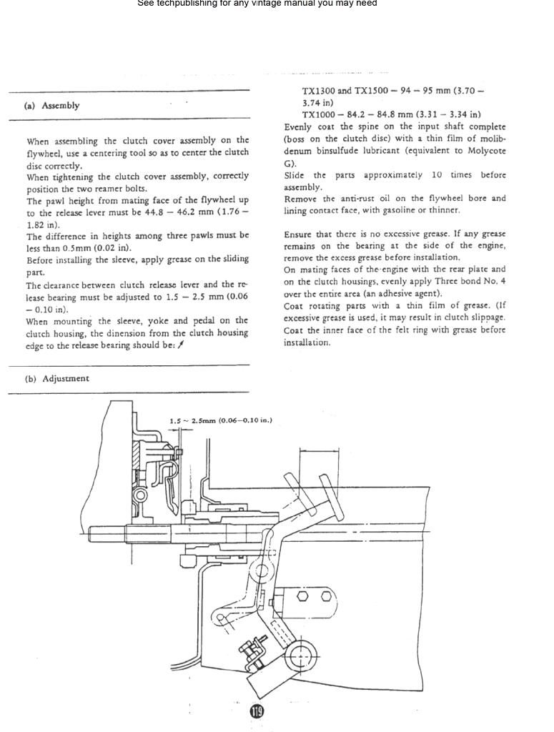

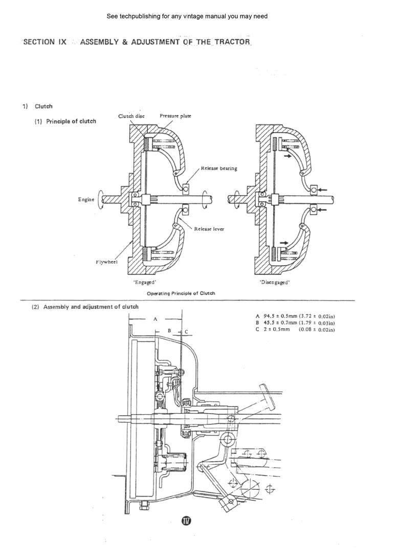

I need to replace the clutch on my Bolens G174, which I bought several years ago at an auction, and of course no manuals. I've found the Users Manual on line, but need to find the manual with the schematics for the clutch. Can anyone help?
   / G174 clutch #2
Here's extracts from the Iseki TX1500F (same as Bolens G174) service manual on the clutch replacement/adjustment - let me know if you require copies from the parts manual too (I need first to be provided with the serial number of the tractor to provide the correct data/illustrations)
